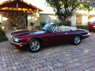

Very nice looking car. Worth looking into some more, and the price is right.
I'm pretty sure it's the straight six 4 Liter version (because it does not have a rear spoiler).
Let us know how it goes.

I agree it looks like a 4.0 with some really nice later 20spokes. That said, mine was only a little less and in similar visual shape. ( 95 2+2 'vert) +1 on the maint records and DEFINITELY drive the car!
Good Luck!

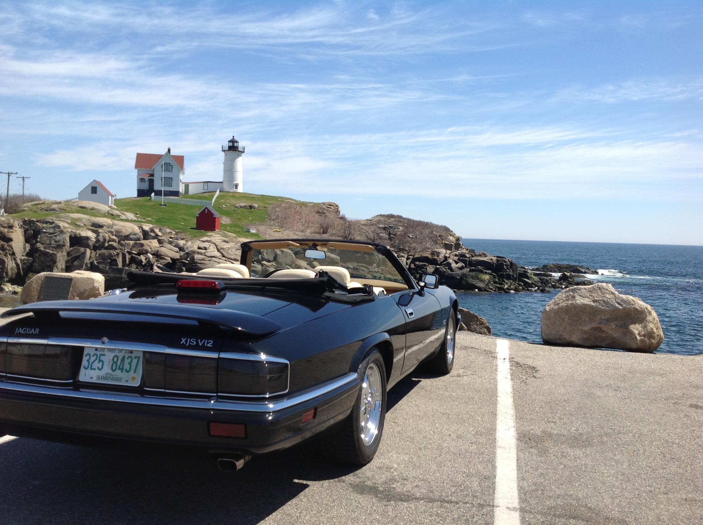

According to the 1994 Model Year Update, "the V-12 is distinguished by the rear spoiler". It goes on to say that it was an option on the straight six.
The 6 Liter for regular XJS's was introduced in '94 (actually 93.5, that's when mine was built). And as far as I know, the V-12/spoiler combination was kept through '95 and '96.

nice pic. I see that your spoiler doesn't have the antenna breaking hole. is your antenna infront of it ?
Old Apr 16, 2014 | 07:11 PM
Bill C's Avatar
Joined: Mar 2012
Posts: 333
Likes: 101
From: Seacoast, New Hampshire
Thanks.
Yeah...the antenna.... it's just forward of the spoiler. I have to make sure it's retracted before I open the trunk/boot. I'll just blame the nicks on the front part of the spoiler on the previous owner!
