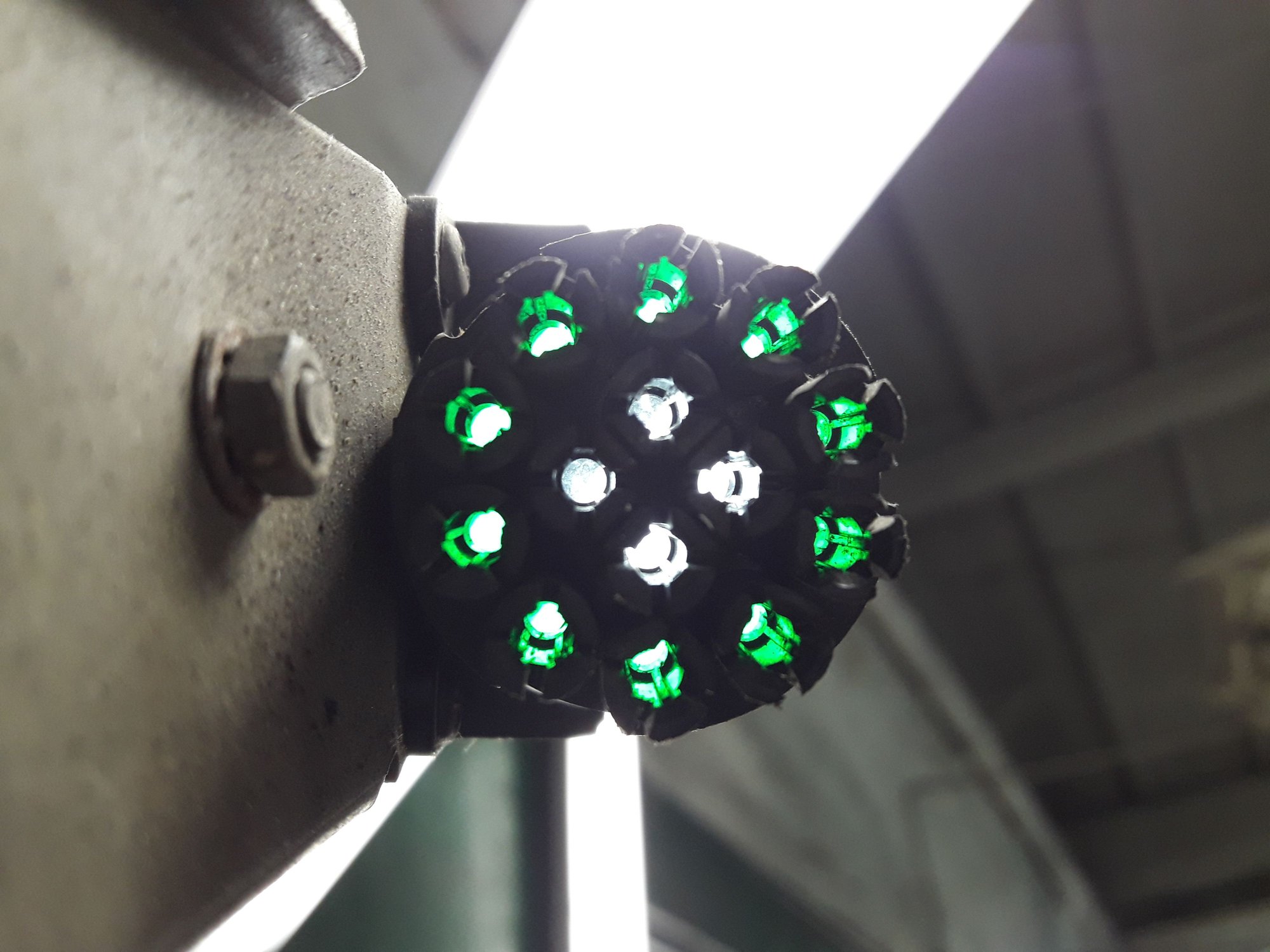

In the center console is a black plastic piece that all the fiber optic wires connect to. It is covered by a flexible black rubber/vinyl piece. The backside has an opening for the light bulb.
On my '87 all but three of the wire positions are used. Does it make any difference what order they are connected. I don't think it would but wanted to ask before I reinstall everything after replacing one of the wires that broke.

No it makes no difference what order they go in

White is for red temperature digits and blue red arrows. Green is for others.
