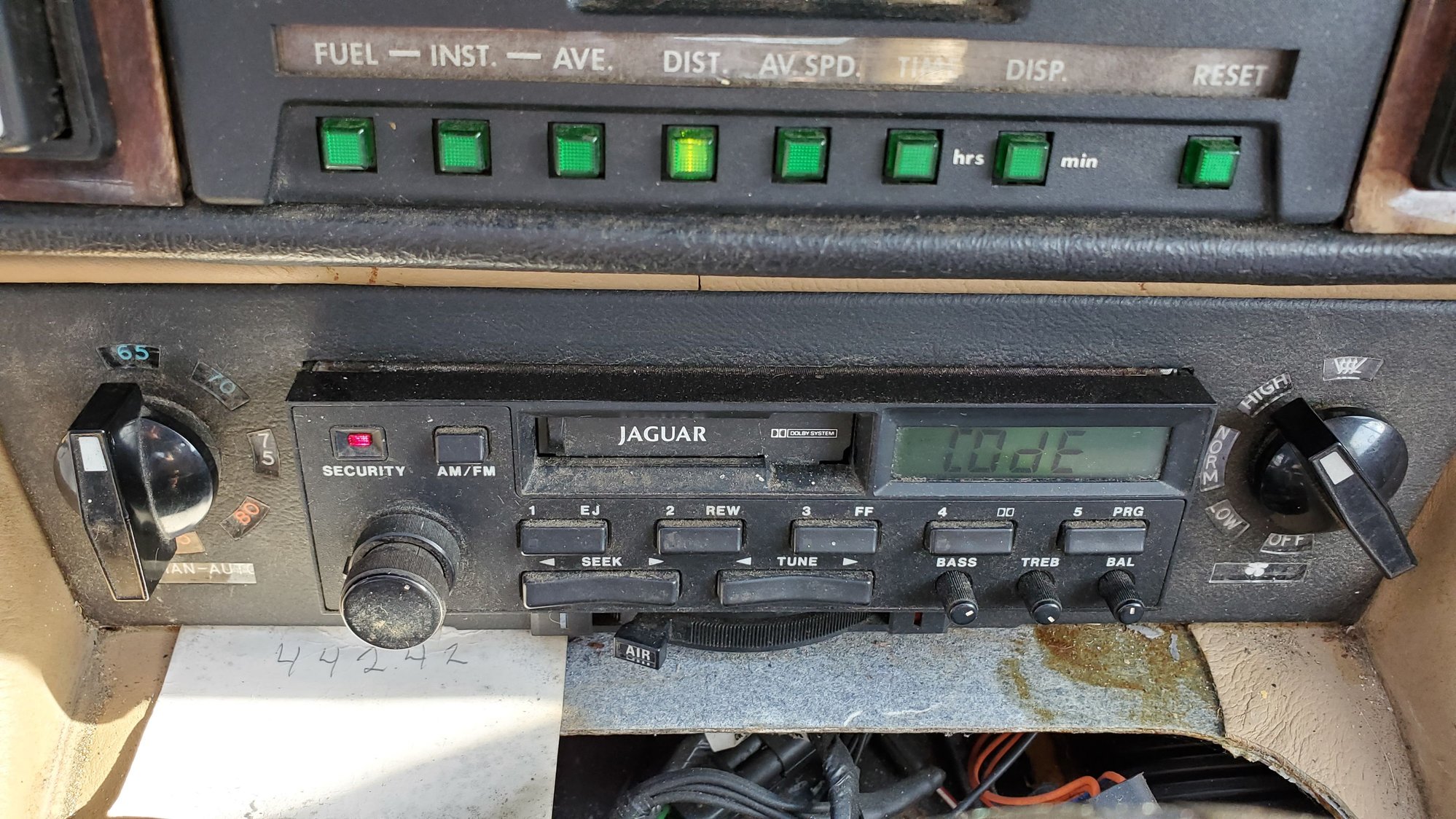

So where should the air lever in bottom middle be?
And RH knob in is auto out is manual right?
I think its working... I can hear a whining fan from behind the glove box but its 17C out and the air coming out isn't ice cold but its cool enough that today I wouldn't be dieing from heat lol
Old Nov 7, 2020 | 10:26 AM
Doug's Avatar
Posts: 25,529
Likes: 11,724
From: Pacific Northwest USA
The slide control is just a 'trimming' device to slightly alter the upper vs lower outlet temperature. You won't even notice a difference until the cabin temp and climate control system have stabilized.
The LH knob has a "pull for manual control" feature. With the knob pulled out you'll simply be getting warmer or colder air as desired; the system will not be automatically adjusting the temperature
DD
Old Nov 7, 2020 | 10:50 AM
Rescue119's Avatar
Joined: Oct 2019
Posts: 1,318
Likes: 597
DD
Ok thanks. I think its working then just needs a refresher is all. The high pitch while (like a bad fan belt) is probably the blower motor. motioned and goes as the system comes on and off. I'll get to it eventually lol
