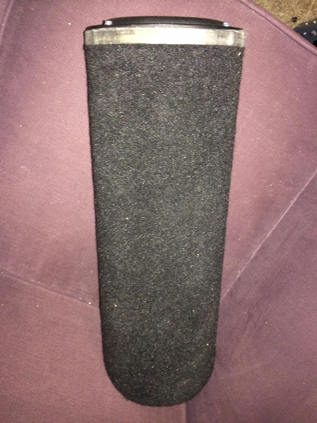

I’ll throw my 2 cents in. I’m no audiophile, but the consensus on car audio forums seems to be to focus on the quality and amplification of your front speakers, as you can get plenty of sound from 2 speakers up front. On your car a 5.25” may be the biggest that will fit without any mods.
You could change the head unit/stereo to install one with an mp3 hookup, or find some other way to add an mp3 hookup to the existing stereo. Changing the head unit would make it easier to add an amplifier.
Or if you go the route of using an mp3 player directly into an amp, you could still send the signal to the front speakers.
I built a subwoofer tube to go in the cubby box of my XJS. It’s just a 6” pvc pipe about 19" long with a 6.25” tang band subwoofer designed to work well in a small sealed enclosure. It won’t rattle the neighborhood, but it will supplement the low end frequencies very well, and you can hear/feel it at 80 mph with the top down.
The sub was about $60 used and the pvc and black carpet, etc was cheap. It's easily removable if I need to use the cubby.
Best of luck whatever you try.
