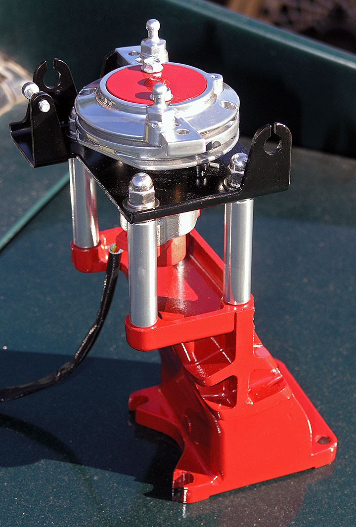

I despise the job. It takes me at least a day to do it, and I always put it off as long as possible.
I did, however, modify my throttle pedestal, so that it is now easier to work around, and remove.
Into Death Valley... are you kidding me?-p4190074.jpg Into Death Valley... are you kidding me?-p4190075.jpg

That's an impressive looking Throttle Pedestal there JagZilla!

I was really surprised to find that the plugs I just installed - NGKs purchased from Rock Auto - were all correctly gapped as I received them. And I agree, even just checking them all was tedious.
That's a great looking throttle pedestal! Nice job!
