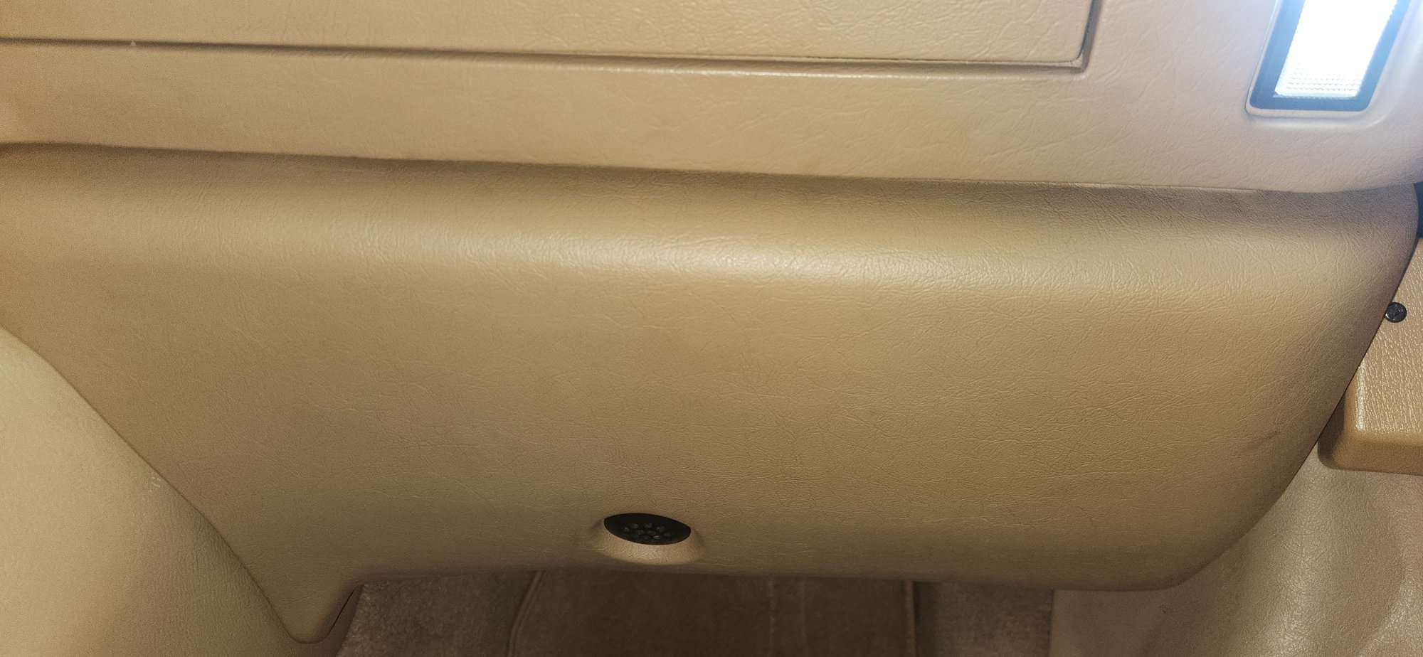

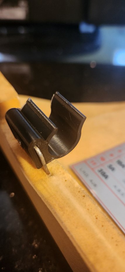

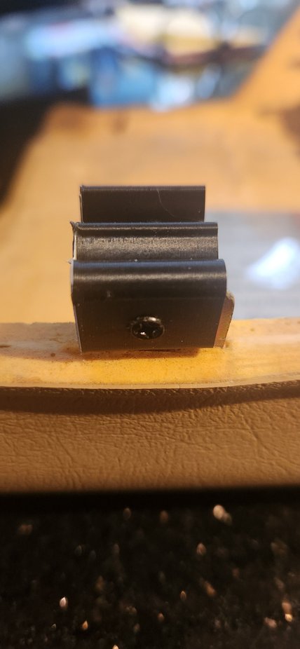

Here are some pics of a repair clip I made for the knee bolster. It requires you drill (and debur) a 3mm hole once positioned. It uses 3mm nut and a 3x6mm machine screw to hole it in place. I used a countersunk screw, but It needed to be around 7mm long(which required some grinding), so I changed the final design and went with a 6mm pan head screw. Before placing it in place I recommend you get upside down and observe how it going into place. I had to rebend one of my brackets( the vehicle mounted bracket) as it had bent slightly upward after being abused over the years. I haven't put too much time on it yet, but it seems to be holding nicely. Here is a link to the 3d file https://www.thingiverse.com/thing:7170014
