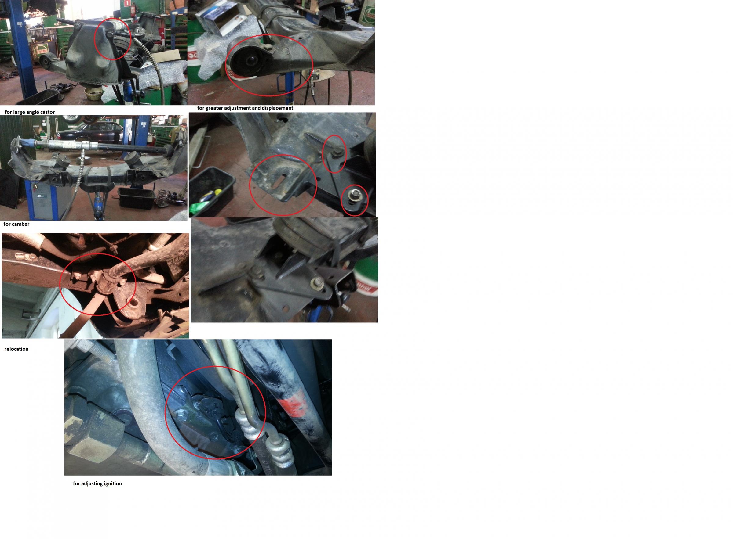

Originally Posted by xjsv12
You chose difficult way. There is no possibility to adjust.
https://www.jaguarforums.com/forum/a...t-if-front.jpg
I see the picture but it does not explain what change was made. Can you tell us what we are looking at?
Mark
You chose difficult way. There is no possibility to adjust. https://www.jaguarforums.com/forum/a...t-if-front.jpg
Do you mean you ground off the crank position sensor bracket from the timing chain cover and fabricated your own?
Or the earlier models have detachable crank position sensor bracket?

It looks to me, that the mounting holes were slotted, and the timing fingers were made adjustable by rotating the whole part. This is exactly the same effect "Andys" bracket has on the 6cyl cars.
Hmm that makes sense.
Actually the bracket of V12, at least on later cars, is casted with the timing cover, so it has to be ground off and fabricate a new one to adjust the sensor. I found it easier to modify the timing disk, for I had the experience of replacing the crank damper.
Anyways I have to thank Andy for providing the timing advancing idea.

Yes, I fabricated slide dracket.
I see, that is better than my idea, for timing is adjustable as you said.
Either way, I really like the idea of advancing the timing a bit. It really changes the engine feel.
