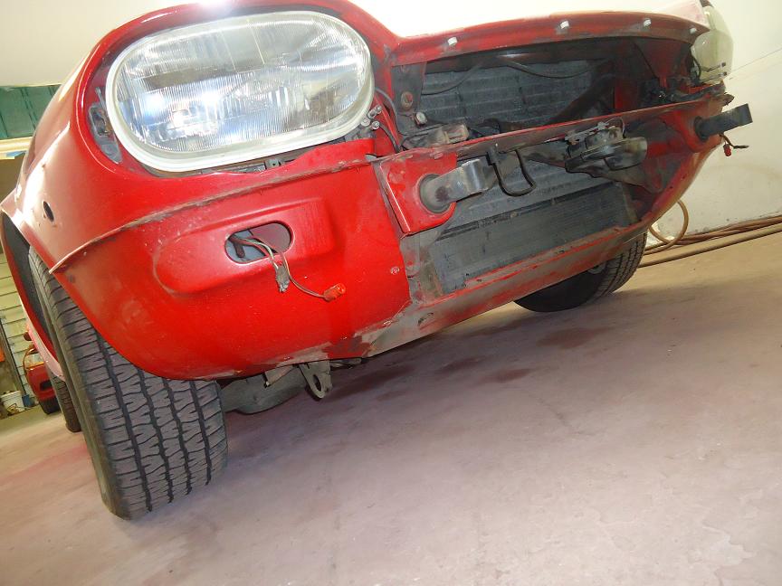

My sweet '89 went in for it's planned strip down paint job last weekend, being done by a respected body and paint man known for his restoration jobs. He works for a large dealership by day, but doing my job in his private home shop.

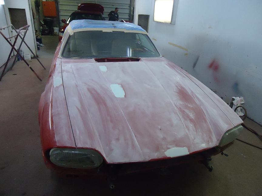

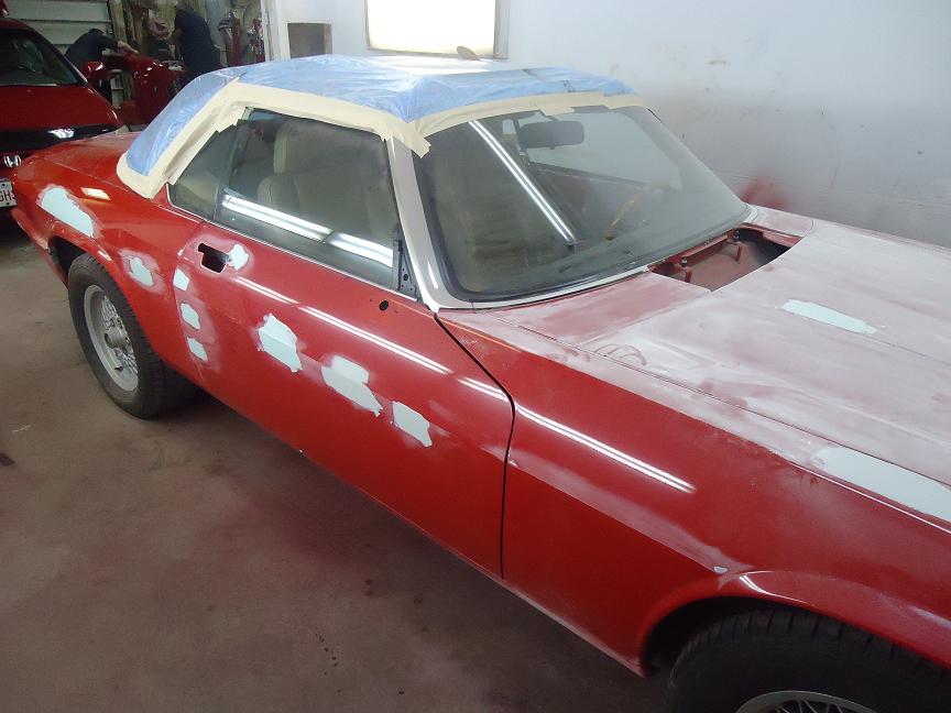

I dropped in to see him tonight to bring him the new spoiler and a new headlight trim since one of my originals had a bubble in the chrome finish. He had almost everything stripped off, and had just begun sanding, and filling a few minor dings in the doors and one on the hood.
Happily, he had only found one surface rust spot the size of a quarter under the rear bumper. He said it was nice to see a car so well built and solid, which actually could be stripped down properly.
His only pisser was he would need to remove the door glass to remove the door chrome strip at the window, and drill out all the pop rivits holding the trunk finish piece chrome trim.

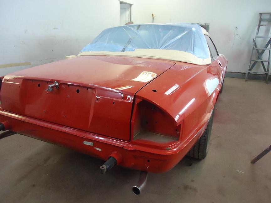

My '89 Convertible has been stripped down, door dings fixed, the ONE quarter-sized surface rust spot behind the rear bumper repaired and epoxy primered,and over the weekend my good body man/painter began spraying the '96 Signal Red -Code CFC water based finish. Four coats later, next day he applied 3 coats of Clear. He has the new Lister Spoiler sprayed, then re-masked to spray each inner fender well black. The photos taken tonight were after the Clearcoat, before the final sand and buffing.
After stripping all the fixtures, we had discussed the potential problem of masking the Convertible top. He showed me tonight, he researched and found how to slacken a cable which runs around the rear deck inside the rag-top which allowed him to roll up the top at least an inch, giving him a good way to paint up under the top, which will not show any paint seam/edge.
He told me he hopes I am not in a hurry 'cause I won't get the car back until HE'S satisfied. I appreciate that. He said probably one more week, as he will be polishing & buffing all the chrome before re-installing it.

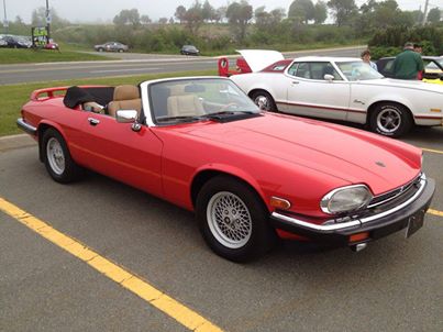

I still haven't taken any decent photos of my baby since getting her back from strip-down paint, but a friend from my local Car Club took one couple days ago, which I have here.
I managed to find a genuine Hirschman Power Antenna, new in box from a supplier in the UK, a newer model with a different plug for power, but came with a plug socket and inserts to do the proper plug-in by simply determining the constant 12v, switched 12v and ground. all holes lined up great for mounting and works super, I now have great FM tunes plus even the 10sec. delay works slick.

Im hoping those pics just happened to be in the process of just applying filler and that the guy didn't just fill in dents and dings with bondo instead of fixing them.

I was there when he was tapping out two dings from the inside of the right door, and I can only guess he did his best wherever possible.

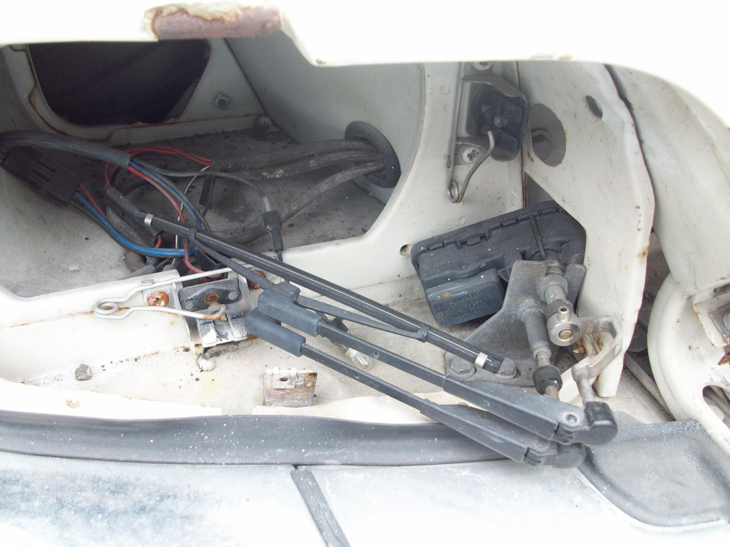

I have a set off headlight wipers on my parts car for your car. Interested?
