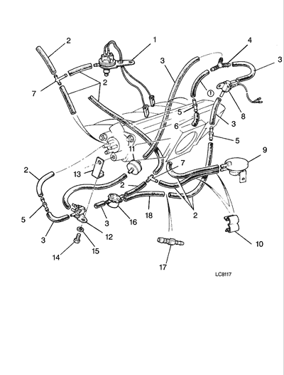

My spare fuel enrichment vac valve/switch, so you know what to look for. It is usually located near 5A inlet track, and has a clamp with a bolt. Some early HE engines are running the early PreHE switch. I will find a parts drawing of that sucker and edit this later, just in case.
Found it, #1 in this parts drawing.

What ECU are you running?????, being an early HE, I reckon a 6CU, which is a tad slow for big throttles. You need to find a 16CU that suits your market, and simply plug it in. ?bay has them mostly.
