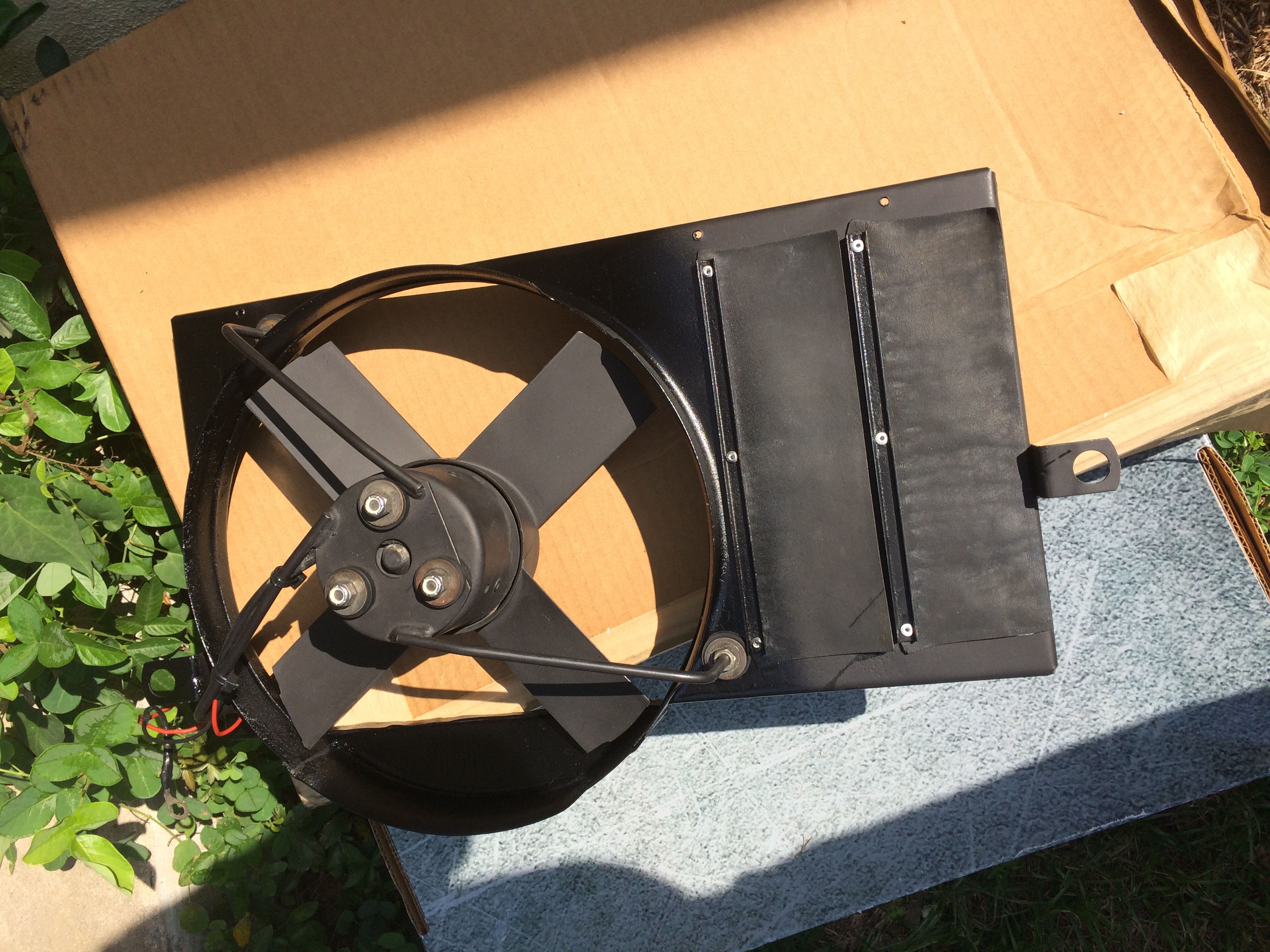

or just unplug the bulit connector to the fan that has the red wire coming from the fan and get a wire and hook it to + 12v
if it does not work...
then trace the Black wire from the fan... it should go to a eye connector that is fastened down with a NUT on the metal
un-connect it and connect it to a known ground -
it should spin then... if not
mine no longer needs the electric fan...
it is for the air conditioner and if the summer stop and go is more stop than go...
oh make sure that the flaps under the electric fan are in place, if they are not it will contribute to overheating while stopped as the air will just loop through the fan and the open holes the flaps close and not be drawn though the radiator

The flaps are in place thats not a problem, I still gotta check the fan, its been raining all day so I haven't gotten a 12V to test it.
