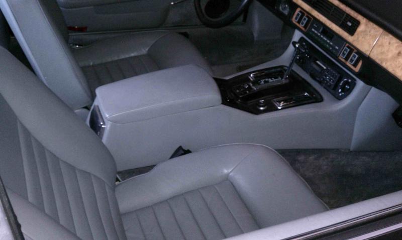

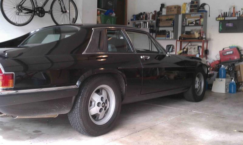

Hey guys I have been lurking around here for a few days and just pick up an 85 XJS Saturday. The car is a one owner with 43k miles on it. It is in great condition and the engine is running well.
So I test drove the car for a good 30 minutes and all seemed well so the exchange was made. On my 40 mile trip home however the trans seem to get caught in 1st or 2nd gear and it still is. The car takes off fine but doesnt shift and if I let off the gas it goes into a neutral sort or thing until I bring the revs back up to 3 or 4k and then it grabs again.

Thanks, I will get some better pictures but the car is really nice that is why I had to crab it! The interior is almost perfect two dings in the whole car that can be removed by a PDR guy...
I should also mention that these cars are nothing like I expected. Very sporty feeling car, solid feeling and corners well.
