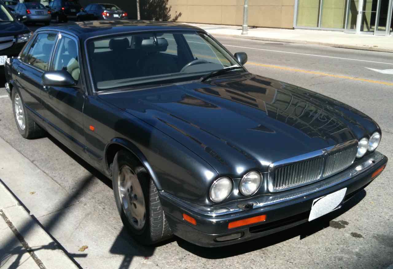

Picture is worth a thousand words here, fellas.

My old X300 in Titanium (LFA).
