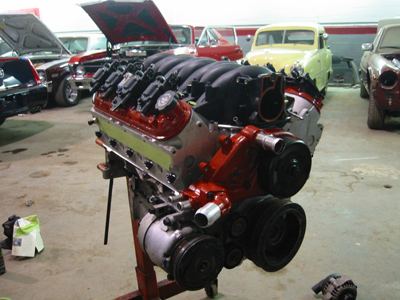

I know this doesn't sit well with everyone, but I wanted a faster XJ6 and this is the best dollar for dollar mod that I could think of:
Performance parts are inexpensive (relative to building a Jag V12) and there is a huge body of experience and information at your fingertips. Yea, it's not a Jag V12, but that's both a bad thing and a good thing. Just a thought!

nothing wrong with an LS series engine,especially turbod, BUT it aint a V12, 12cylinders is about the talk not the walk, and the sound thru a nice exhaust is encredible, they dont rumble they whine!
check my garage, Buick grand national, after blowing up two turbo engines, in went an LS2 6.0L with a 4L80E trans. now its a real fast and DEPENDABLE car.
course usual brake and suspension upgrades,
but my jag gets more looks than the buick at car shows, owning these old cars is about (mine is bigger than yours) yaya. or something to that effect.
