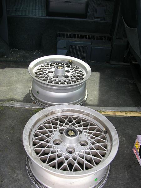

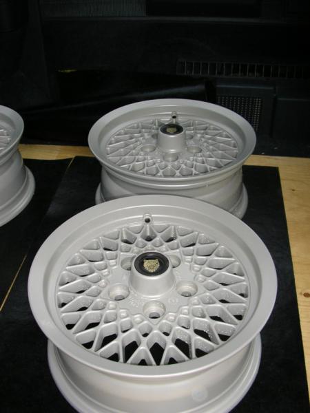

I went with powder coating. The finish you speak of was all peeling, powder coat was the cheaper (50%) option and worked out well for me at about $65Cdn per wheel. There was some kind of coating on the back side, where the wheel meets the hub and the guy who did it for me had a hell of a time getting that off. Still my wheels looked,and still look great. I know there was a company in Calgary that refinishes them for around $130 per wheel at that time so you can probably find something in your area. I have and may have posted some before and after pix, if you can't find them PM me and I 'll forward

Very nice. Here are before and after. sorry the look wet.... it was pouring when I loaded them in the van
