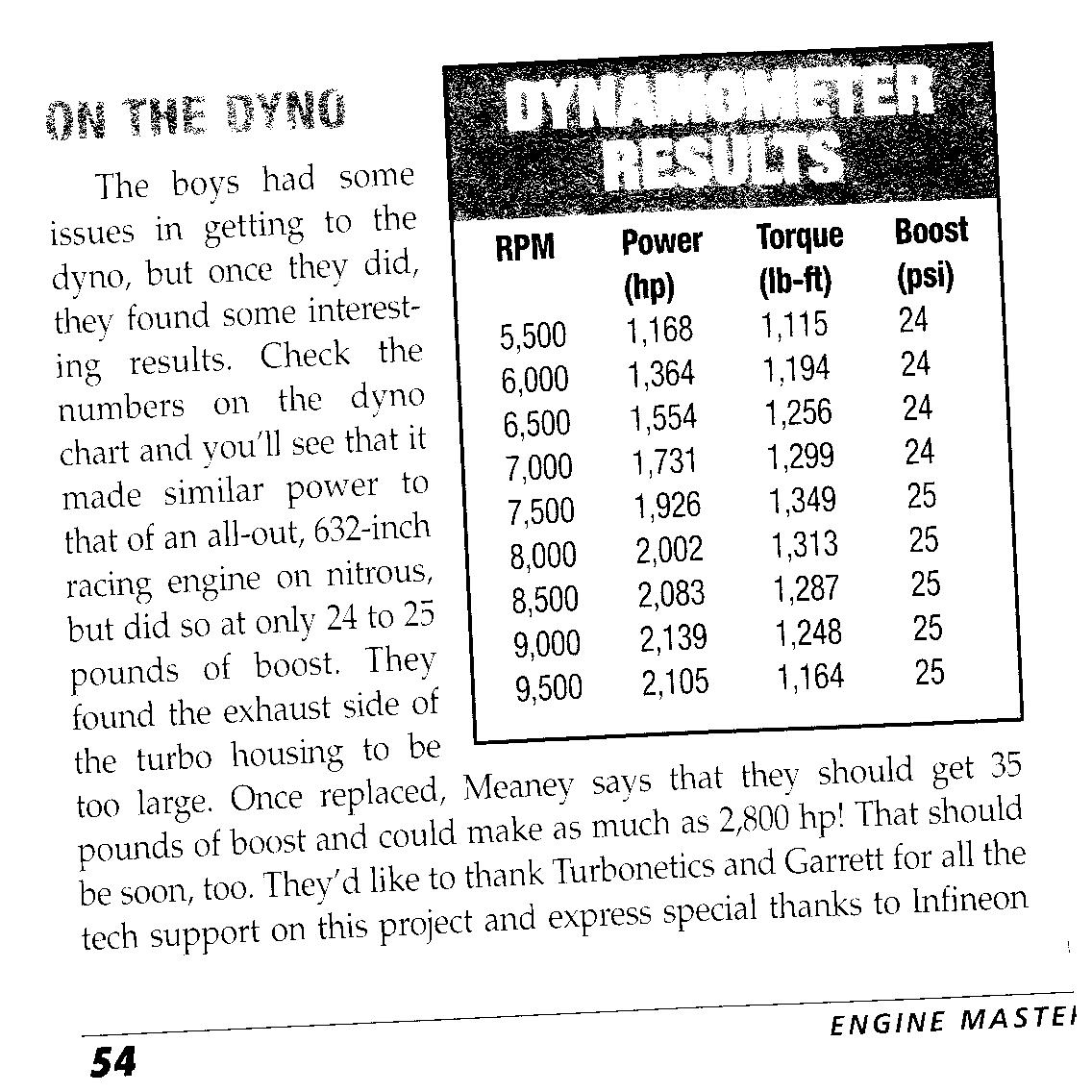

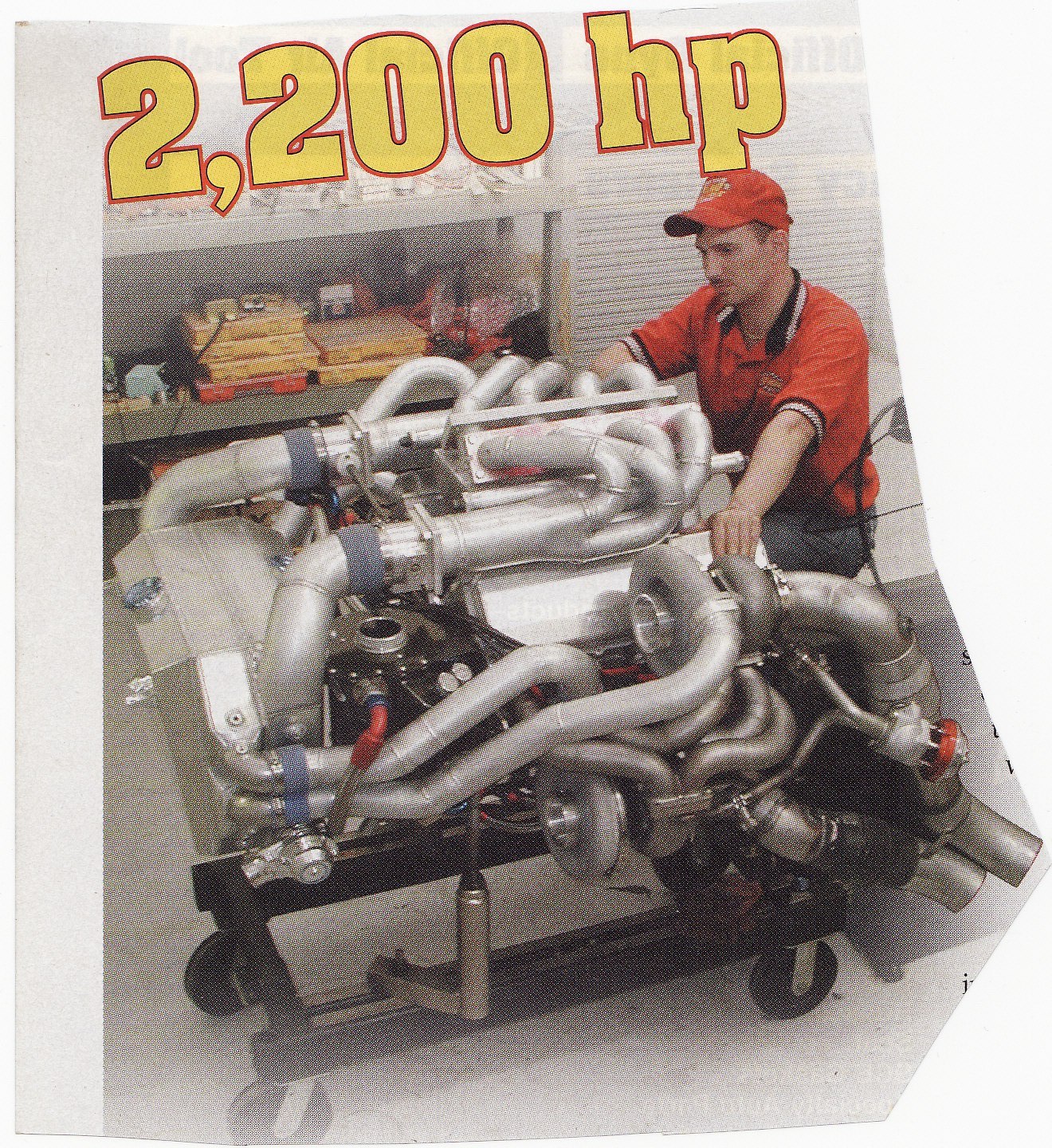

just remembered this pic i have in pix,
Mike Moran king of turbo engines, 2200hp back in 2003, he's now at 3000hp!
he originally used 4 turbos, but went back to 2 large ones, was difficult to make consistent results,(tuning etc).
nothing much just an OLD BBC,chevy
