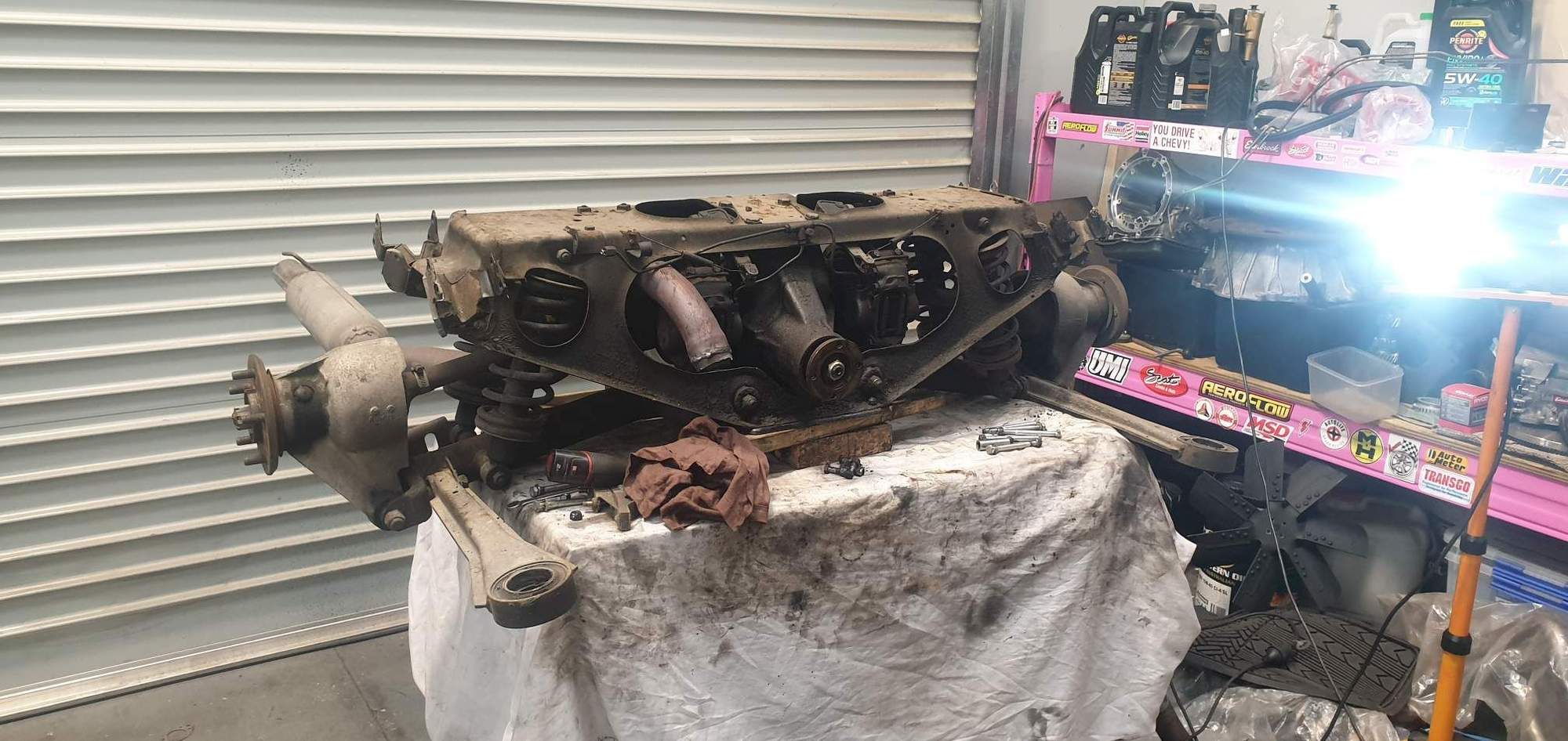

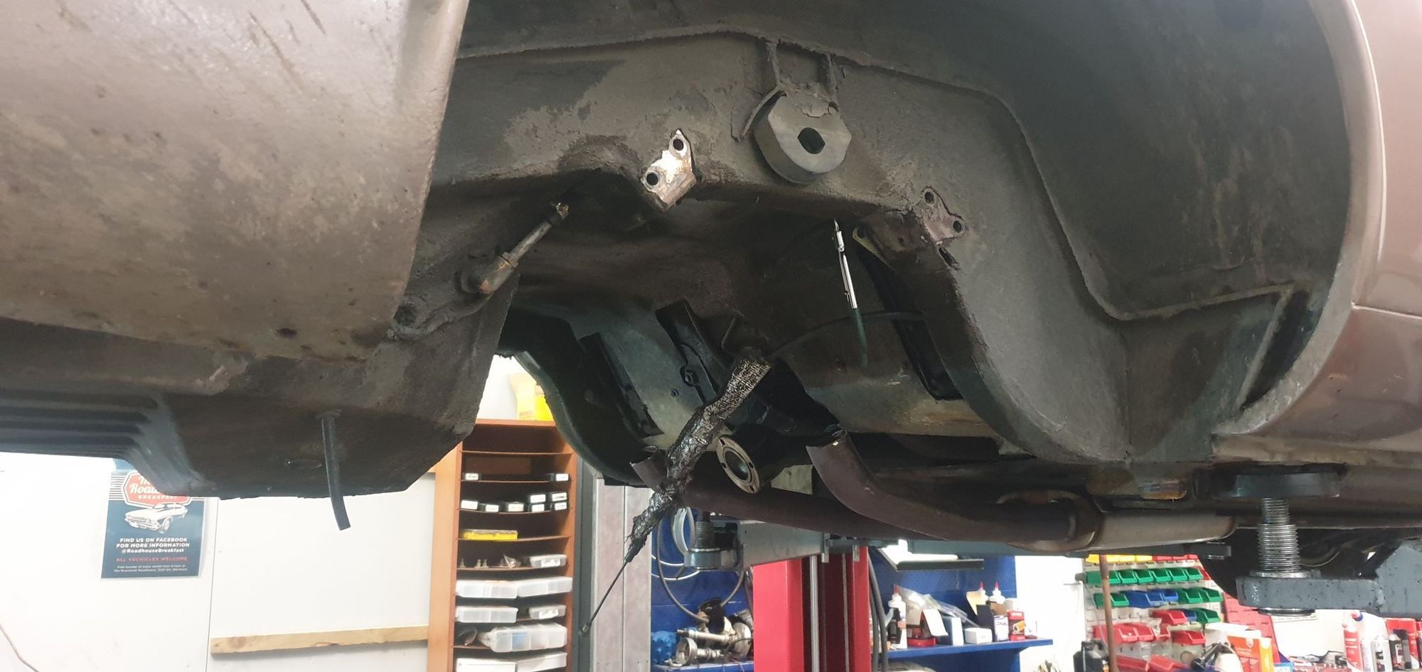

Finally found a gap in my mechanics schedule!
Needed a hoist for this one.
IRS removed,
New pumpkin going in...
