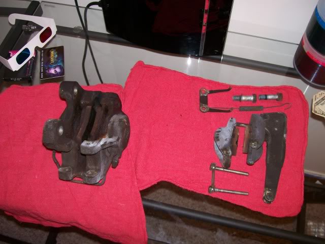

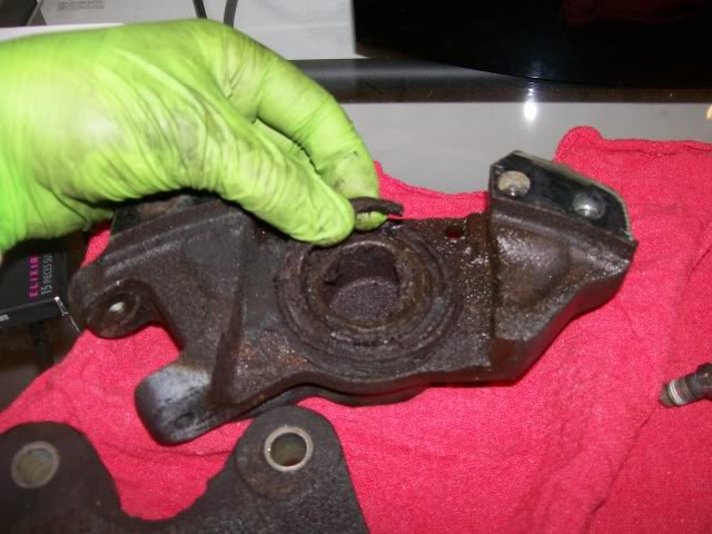

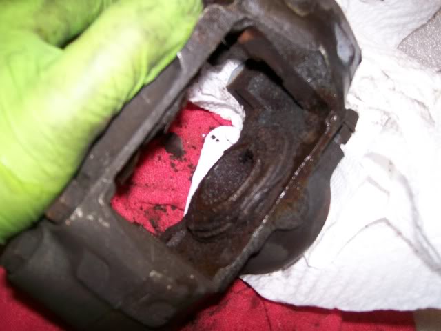

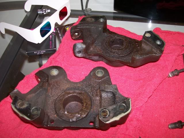

i thought id post some pics of how this goes, its been the same 40 degrees all week but i said screw it and put on some coverall and removed the left caliper.
and this is why it was leaking lol...
old british rubber vs American Dot3

Keep posting pics as you go Sidescrollin, it all helps.
One good thing I suppose, is that you can tell that the other end is pushing fluid to the calliper.
PS, love the 'Bins' BTW

Sorry, just realised from the picture the rear calipers, unlike the fronts, have a transfer pipe between each half, so no internal hydraulic passage, but there are still the high-tensile bolts. I would not be happy putting back the originals.
