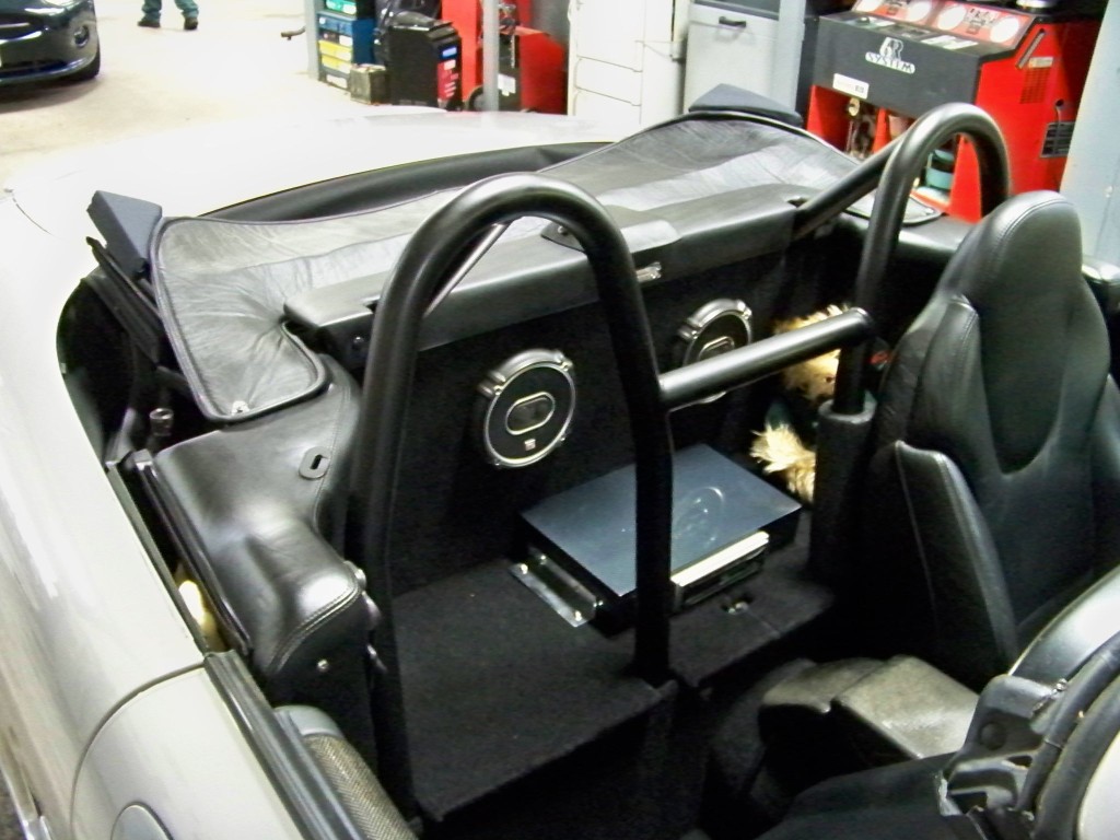

Here is a picture of my XKR with a roll bar fitted. I purchased it from Safety Devices in the UK. The floor pan on the XJS & XKR are similar so this may bolt in.

Thats a nice roll bar. I was going to mock up roll bar 2 convertible but I bought a 2nd xjs coupe and that takes my time now. 89 not running so no rush

Thanks for the pic. It looks like the configuration on the XJS conv. would be similar if the storage box was completely removed. I'm not familiar enough with the vehicle yet to know for sure. I suspect that it might not accommodate the brace tubes going rearward. As I recall, the top (hood) sits on a deck just to the rear of the storage box when it is lowered.
