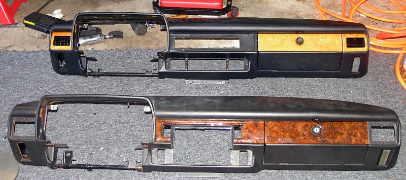

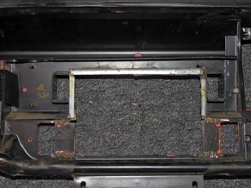

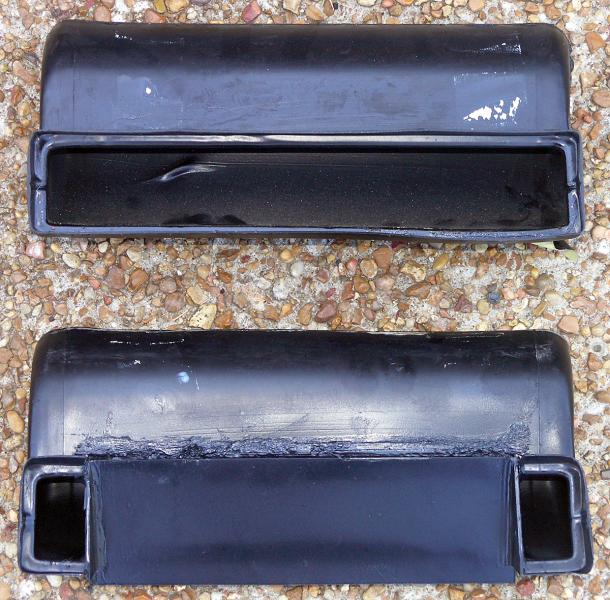

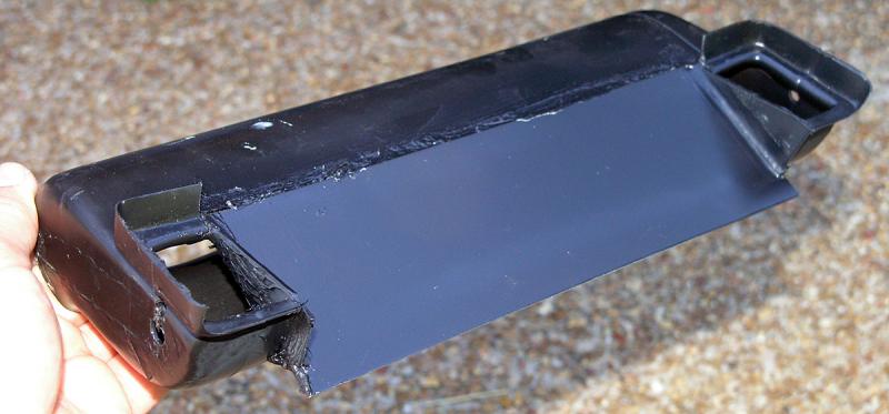

@ Mark and Scott (SARC):
I don't think there is enough room for a double DIN unit in this dash, because of how the AC unit fits behind the dash. See for yourself by checking out the attached photo of the interior with the dash removed. However, I seem to remember seeing photos on Jag-Lovers of a guy who successfully fitted a motorized unit with screen into the stock position.
I removed that dash and transferred it into JagZilla, so I know quite a bit about how it was done. I have attached photos of the metalwork which went into this mod. It wasn't elaborate, just your basic measure/cut/weld. It's actually pretty sloppy work, but, all the ugly gets covered up by the pretty new wood.
The center vents were not completely sacrificed. There are small ports on each side of the screen, which allow cool (or warm) air to flow. Only the center grate was entirely sacrificed. However, that is no big deal, since a popular mod among XJS owners is to block that grate, so the directional vents on either side of it will have stronger flow, rather than allowing most of the air to shoot out that grate, and straight toward the rear window.
One of my problems with the way the PO did this, is that he didn't address a means of directing that airflow through those small ports, so it just shoots straight out. I am thinking about further modding it by enlarging those ports vertically, so the original vents can be used, but, they would need to be rotated 90 degrees, so they would be vertical instead of the stock horizontal positioning. I'll then have new wood panels made to make it look right.
That whole center vent area in a stock XJS is just one big horizontal opening in the dash with a plastic "S"-shaped duct (when viewed from the side) supplying air from the blower opening, which is located higher behind the dash (the air actually flows down to that center vent). When the PO opened the dash up for the touch screen, he left that duct untouched, and that screen simply pops in and out of the opening in the dash with very little effort. However, I think this is a poor idea, because it causes the back of the touch screen to be utilized as one part of the duct wall. That's not so bad when you have the AC on, but, when you run the heater, you have hot air blowing directly onto the back of the touch screen. That's never a good thing. I thought a better way to do this was to notch JagZilla's duct in such a way that I could create a fully enclosed duct (with the exception of the lateral ports) using a sheet of styrene plastic (available from any decent hobby shop). This insulates the back of the touch screen from warm air when the heater is on.
Confused? I've attached several photos which will help explain the PO's original mod, as well as the center duct mod I did. I'm also attaching a photo of how things look when the dash is removed, and a couple photos of the dash before it came out of the donor, which will show the center section better. One photo shows the screen active and lit up. The other photo better shows the PCs DVD drive mounted under the stereo. It's not a "DVD player" for showing movies (although it can certainly be used for that), but, an actual DVD drive which is used to load programs onto the PC.

Attached Thumbnails Show Us Your Dash!-convertible-interior.jpg   Show Us Your Dash!-dash-touchscreen.jpg   Show Us Your Dash!-dash-removed.jpg   Show Us Your Dash!-modified-stock-dashboards.jpg   Show Us Your Dash!-backside-stock-modified-dashboards.jpg
Show Us Your Dash!-backside-modified-dash.jpg   Show Us Your Dash!-modified-stock-center-ducts.jpg   Show Us Your Dash!-modified-center-duct.jpg
