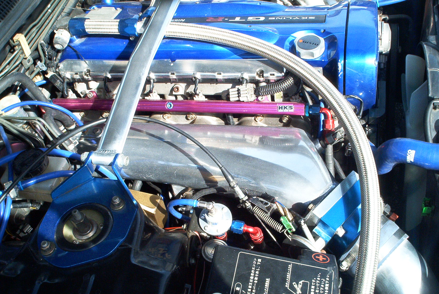

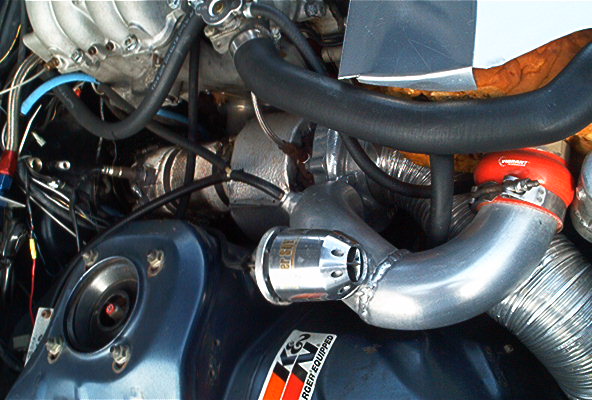

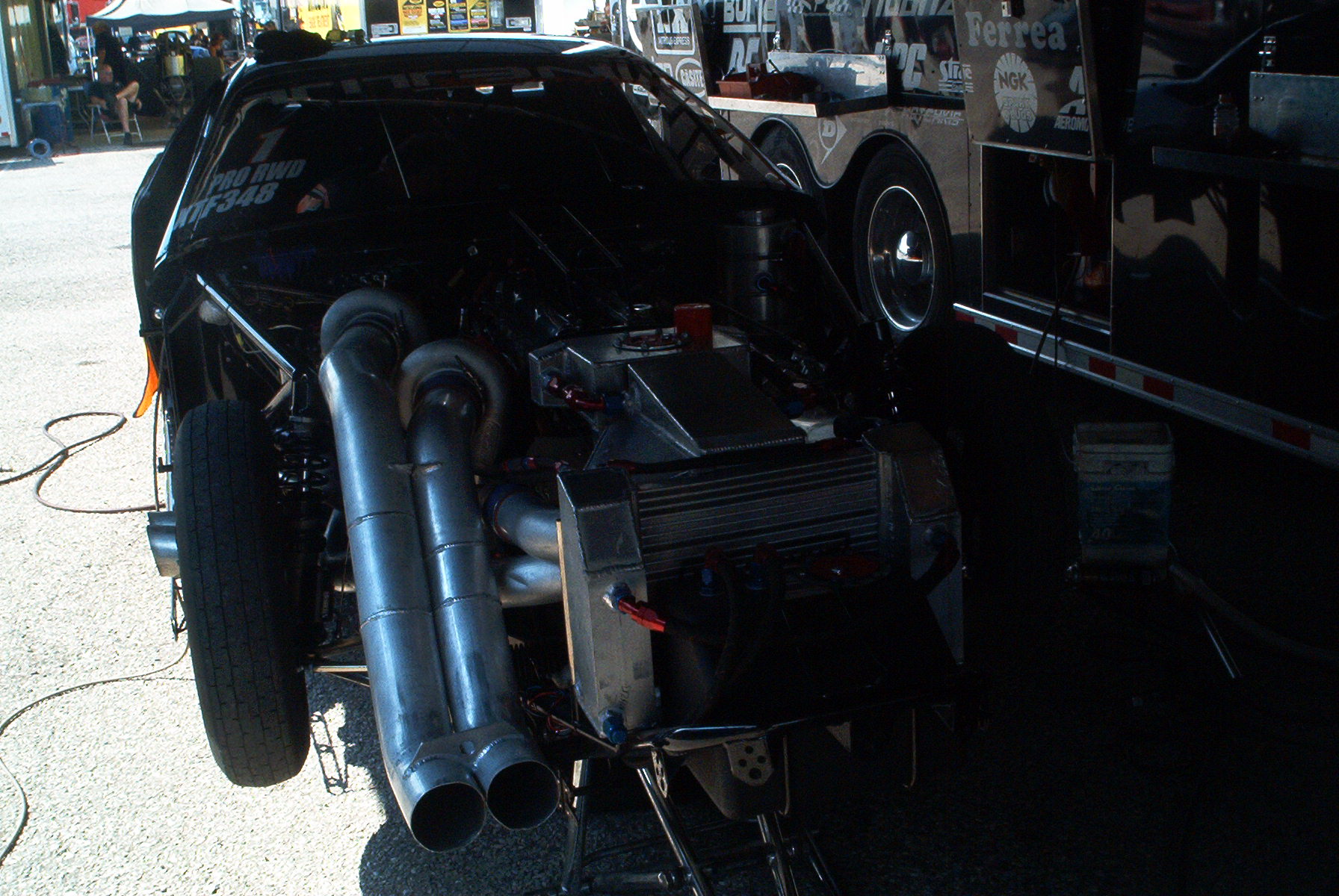

pix some of the cars that are local except TITAN out of Orlando fl. all pix are 5-10yrs old! skyline was in my shop, the build of a RED RX7 intercooler set up flat mount up front, other is my own blue RX7 with water to air I/C back in 1999.
i persnally witnessed one make 1410whp on a dyno. SUPRA.
at 125mph hit the throttle and tires spin car goes sideways, Yup its scary, i have changed since i was young, but not all that much, damn, any time someone gets beside me i start to raise the Adreniline!
hey i can set you up for a run, if you get down around here! LOL,LOL
a shame that a lot of guys on this forum dont appreciate a good street race!
Attached Thumbnails so has anyone actually made 500bhp from a v12 pre.he-dallas-race-2007-002.jpg   so has anyone actually made 500bhp from a v12 pre.he-dallas-race-2007-003.jpg   so has anyone actually made 500bhp from a v12 pre.he-nissan-r33-skyline-720-whp-006.jpg   so has anyone actually made 500bhp from a v12 pre.he-nissan-r33-skyline-720-whp-013.jpg   so has anyone actually made 500bhp from a v12 pre.he-nissan-r33-skyline-720-whp-004.jpg

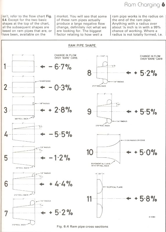

Have you read Allan's book? towards the end where he dynoed a 6.0L in various stages. The last was to add the intake manifolds from the GrpA car, they lost power below 4000 and did not make more power until after 6500.
I think Ron said it earlier that what the car needs is longer intake runners. I don't think it needs larger TB's The LS guys are making 600hp with a single 90mm and the dual 63.5mm stock TB are the same area as an 89mm. Just profile them correctly.
Old Dec 19, 2013 | 12:48 PM

how should I profile the throttles?
Old Dec 19, 2013 | 12:51 PM
  #237
calvindoesntknow's Avatar
Posts: 882
Likes: 65
From: new york
how would I make the motor have a higher max power band?
Old Dec 19, 2013 | 01:33 PM
  #238
warrjon's Avatar
Posts: 4,638
Likes: 2,583
From: Vic Australia
I would machine a taper to the butterfly, being careful not to intrude too far as to affect butterfly closure. There are bolt holes in the mouth of the TB that need to be covered (Take a look at the AJ6 TB this is poor design, the holes on the edge of the TB will create turbulence). By machining a recess in the mouth of the TB and inserting a bellmouth you will have a smooth entry.
I'll see if I can find my paper on bellmouth profiles and flow.
Air flow in any vessel (AKA air filter box or Plenum) the air on the walls travels slower than the air in the middle. so having a bellmouth protruding into the airbox slightly will increase the velocity through the TB.

Here is the flow bellmouth article
Attached Thumbnails so has anyone actually made 500bhp from a v12 pre.he-flowwithstackssmall.jpg
