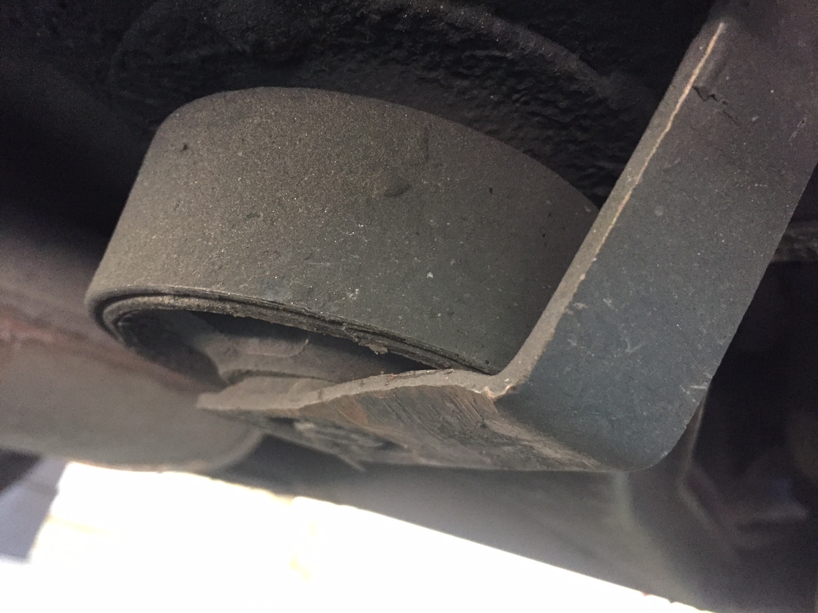

I've been trying to hunt down a creaking sound that occurs randomly during take off from a full stop, but couldn't ever pin it down.
I noticed today that there is some damage on a piece of the rear suspension that I don't know the name of (see photo). Would that cause my creaking like noise?

Shouldn't cause the noise. That's a safety strap, it holds the radius arm up in case the rubber mount should ever fail.
Well that rings a bell!
Sure enough going back to my old thread:
Originally Posted by baxtor
Another possible cause while not common can lead to the "at take off" symptoms is a deformed safety strap on radius arm to body mount. I have seen them deformed inwards to the point where they only just clear in a standing position but when power is applied the radius arm moves slightly forward making contact with strap.
At the time, I didn't know exactly what he was referring to, and was distracted that maybe the exhaust was the cause.
I clearly have a deformed strap and it is nearly touching the radius arm. Can the safety strap be pounded back into shape, or does it have to replaced?

Bend it back in place. I wouldn't even take it off the car. A prybar or even a giant screwdriver would do it.

Hi Mac . . . and also subject posts across other XJ platform variants. Great you have posted a good pic to show deformation clearly. I agree possible fix, but don't be surprised if strap tougher to correct than you expect.
Up to you, but I recommend supporting trailing arm near bush, then remove strap, straighten strap, replace . . . oh, and check other side!
Cause of this crush damage is both silly and preventable . . . lazy, ham fisted placement of floor jacks or hoist pads will bend the bar up instantly. Add to routine under-body check every time car is serviced.
