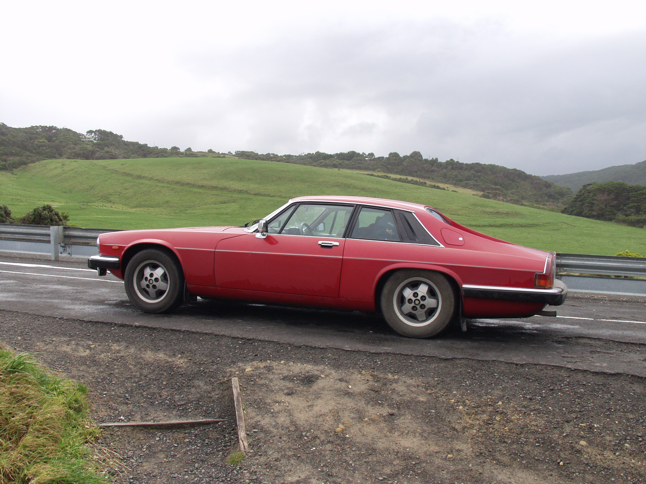

Here are a couple of pics of mine. Stock front springs with packing spacers removed and HD standard ride height Lovells on the rear. If it ends up too low at the front you can always add spacers under the springs.

Yes it will.
I removed ALL the metal panels behind the front bar and replaced the TH400 with a 4L60e, and it's about 45kg lighter now. With the spacers removed my car now sits at the same height as it was originally with them.
To lower the front of the car you can add a spacer between the spring pan and lower wishbone. I will need to do this as my car is sitting a bit high at the front.
This pic is before I modified it.
