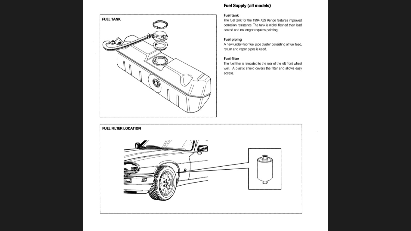

I was just looking through the "94 XJS Update" file that I have. It states, "The fuel filter is relocated to the rear of the left front wheel well. A plastic shield covers the filter and allows easy access."
