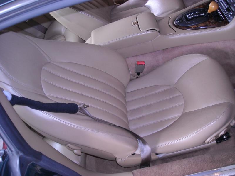

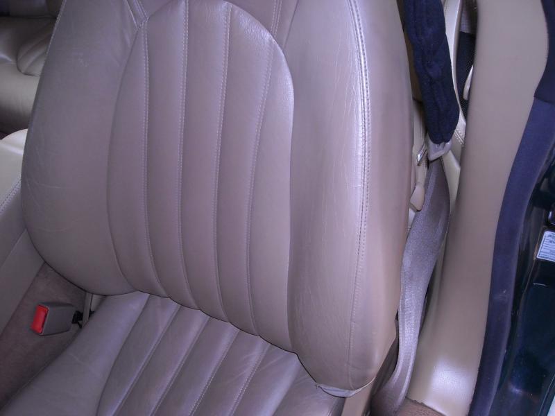

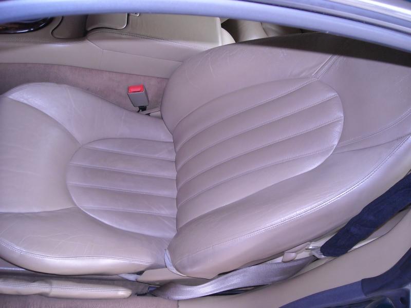

I just did my seats last weekend, time consuming but worth it. they were really shot, I was going to buy new seats. Tried this from ebay, it comes from the UK, good stuff.
