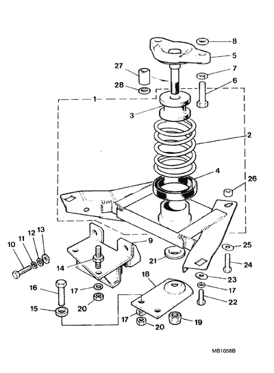

Hey there,
again, I've been "stoooopid" and forgot to take some photos of the transmission mount construction BEFORE removal. So that means I can't properly get the parts together that I will need to install.
All I have is a picture of my hydraulic jack holding the rear "pin" of the transmission, so I had already removed both brackets...
Does anyone here have any pictures of the entire (!) bracketry (well overengineered!) to mount the tranny? Mostly regarding this part (No 1 in picture):
Cheers!
Damien

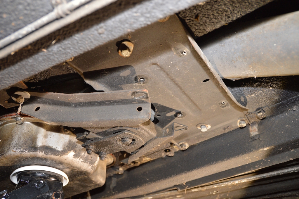

All I have from when I pulled the driveshaft from my '90 parts car.
Transmission mount/bracket V12 - pictures required!-sdsc_9077.jpg
Transmission mount/bracket V12 - pictures required!-sdsc_9078.jpg
Padre

Originally Posted by xjsv12
Fast search
I know that part... That is self explaining. I meant a picture of the part in my picture MOUNTED to the car...
Attachment 140477
Attachment 140478
Padre
Exactly what I was looking for Padre! Cheers and many many thanks!

The piece that bolts to the floor isn't symmetrical, the bolt holes will only line up in one orientation.
