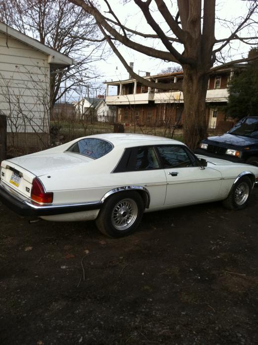

i meant aav valve. heres the car

The irony...mice attacking a big cat.
Nice car, looks good in white. I envy you your curvy roads (thinking of 61 through the coal).
