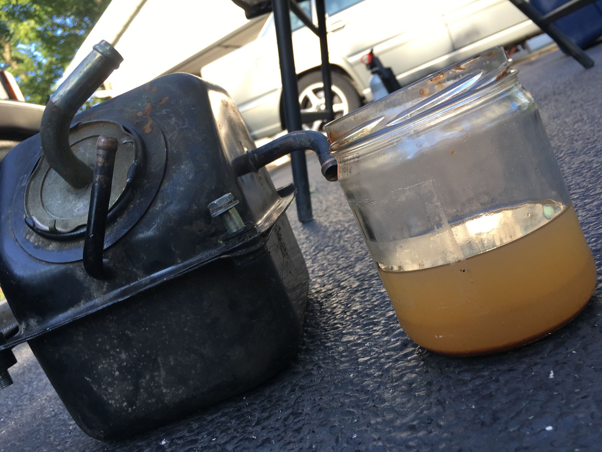

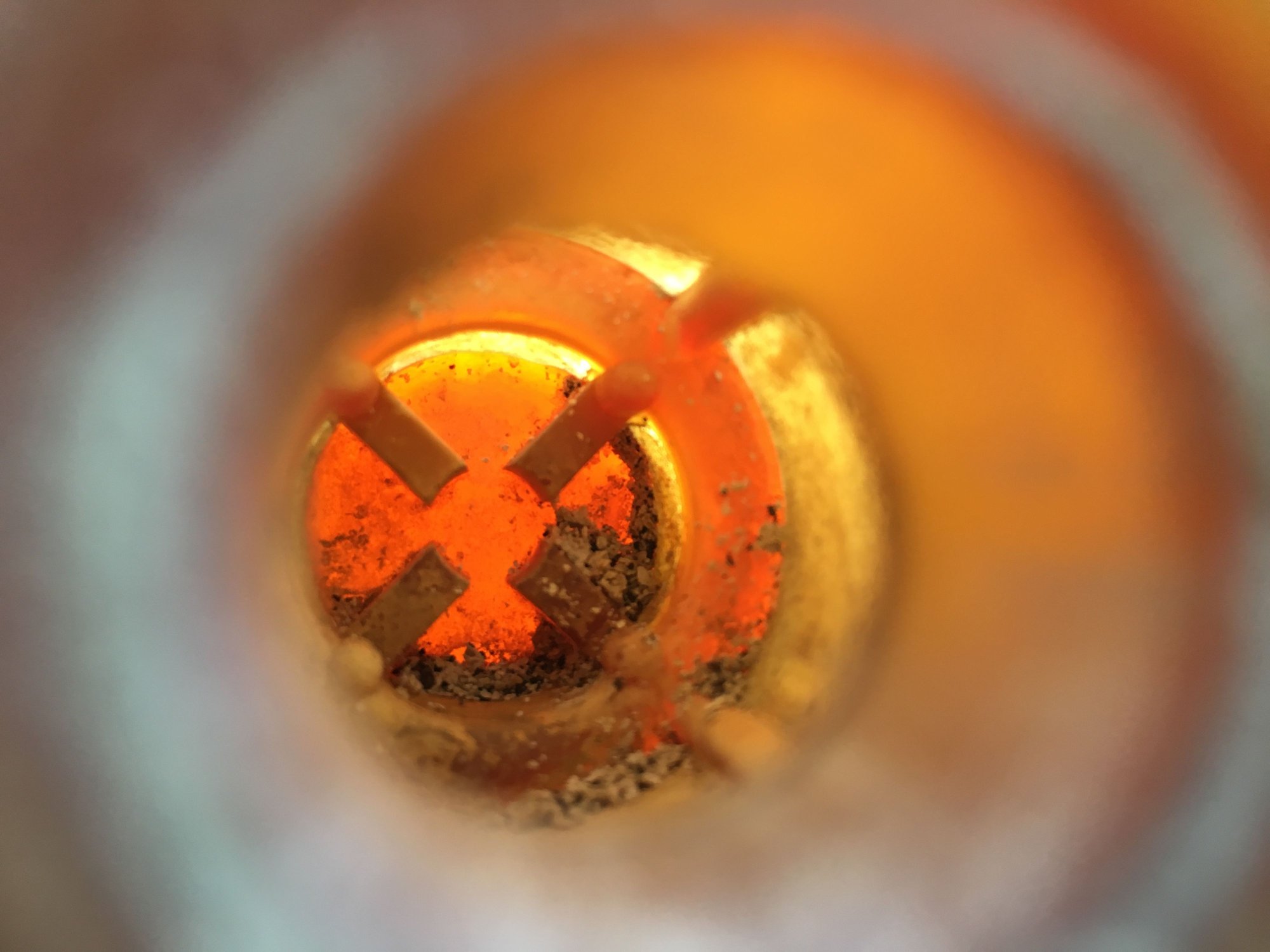

i changed the filter a couple weeks ago and the gas that came out seemed separated. So I figured maybe the gas was all bad and was the reason my car won't stay running. Bought a siphon pump as I assumed a good few gallons should be in the tank... nothing. That's weird. Grab the sump and shake it and can tell nothing's in it, just a little bit. From the photos below you can see it was full of rust and dirt and upon opening the main tank at the float... there was just about a half gallon in it and some more crap inside it. So I must've finally pretty much run the gas out of it last time it quit but I can't believe the little amount I ran it it went through that many gallons. I don't think I have a leak anywhere... at least not in the back. Anyway I'm going to get a new filter for the sump and toss in a new fuel pump since I have it apart for the second time(not doing it again). Hopefully all this crap in the sump is my problem.

Now that doesn't look tastey!

Ha, I think I filled it with orange juice

looks like you emptied a plant pot, surprised it ran at all

It might be worth taking it to a radiator shop and having them "boil it out".

may as well clean the injectors again, while you into it!

yeah that's something that's really made me upset with myself. I do all this work and forget cleaning out the sump which I now realize it's probably the thing that should be cleaned most. If the injectors are fowled again I'll be so mad. I'm going to toss sea foam in it right away.

ive called a bunch of shops earlier in the year when I had my main tank out. No one will touch tanks around this area.
