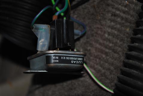

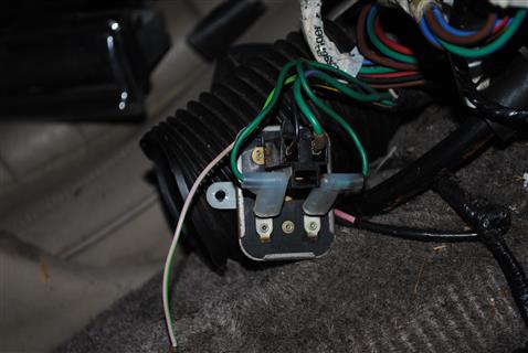

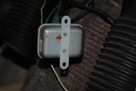

My second question is about this lucas thingy it is located in the tunnel under the back of the skislope. It has a black 3 pin connector and two single pin connectors with green wires.

The second, ah memory will not work, but being a Conv, and USA market, I am thinking the "bulb failure thingy", or, something to do with the roof up and down, but then the THIN Green wires say NO to the roof, and head me back to the bulb failure.

I believe it is a lamp failure sensor

@Grant Francis thanks, I was in doubt whether is was a part of the alarm system, which I'm discarding now or a OEM part. Wiring harness is a mess. Now I'm removing all redundant wiring.
@YycXJS thanks that is the thingy I'm talking about.
@Malc4d Thanks for taking your time, I'll go with YycXJS

The grey Lucas labelled "sardine can" with mounting wings is the Stop Lamp Failure Sensor, basically tells you (via dash warning icon) if your brake lights are out. If it goes bad, your brake lights won't work as it passes power to them. Ask me how I know...

@inertian thanks for the extra information now I not only know what that thingy is but also understand how it works.
