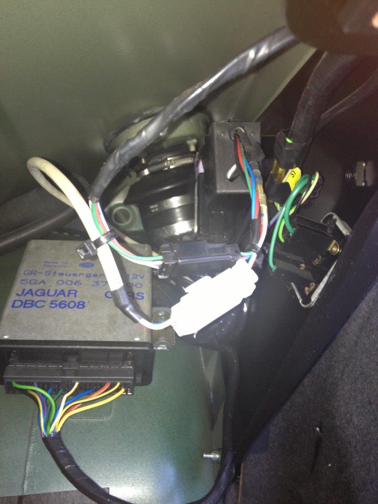

My service manual says it's supposed to be in the driver's, or left hand side trunk, up by the rear windshield, but all I can find there is my cruise control module.
Is it behind the spare tire?
Thanks.

On my 94 it's on the the left side of the trunk above the wheel arch. My cruise control module is in front of the passenger seat.

All I have on my wheel well is what's pictured here:
Attached Thumbnails Where is the ABS Module in 1996 Facelift?-jag-wheelwell.jpg

Hmmmm, very odd, so what's under the cover in front of your passenger seat?

Did you ever find it? I was reading some old bulletins and one said the module had moved to the right rear of the engine compartment when the change was made to the Teves IV system.

Yes, I did find a drawing that showed it located in the area near the ABS pump itself.
I'm assuming my module is connected to the pump controller itself. Theres a bolt that keeps this multi-pin connector hooked to this unit.
1995 1996 1997 XJS XJ6 ABS Pump Controller LNA2210AA | eBay
Has an excellent shot of what I'm talking about. If you slide over to the third photo you can see the connection clearly.

Looks likely but it is rather odd that the electrical manual and parts lists still show the old part and location. It's the Jaguar way though I suppose?
