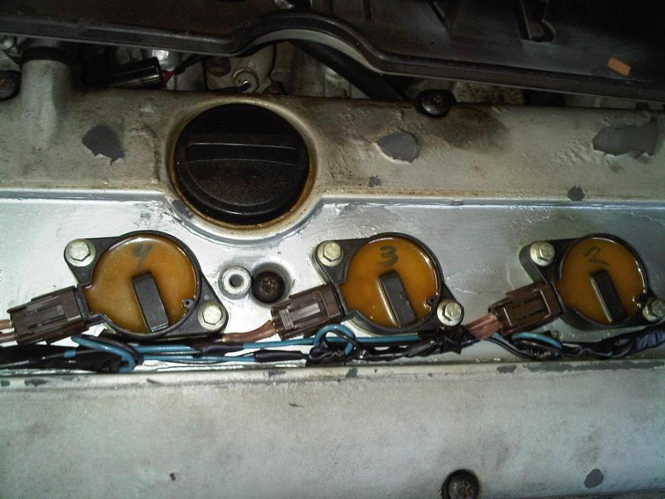

This quality work was done by Alpine Jaguar of Fort Lauderdale, FL. I took my car to them a little over a year ago for a mis-fire problem that I did not have the time to work on.
The issue was caused by the portion of the wiring harness that connects to the coils. The shielding on the wires was brittle and was coming off of some of the wires. This was causing them to randomly short-out.
The "service manager" informed me that "the technician rebuilt the wiring harness to the firewall" and that the problem was fixed.
The problem was fixed, however, imagine my surprise yesterday when I performed the major maintenance on my car, which includes replacing the coil gaskets, spark plugs, et al.
Duct tape?! Electrical tape?! What a genuis idea to use tape that is only rated to 176° F.
I am truly appalled and plan to write a letter to the owner of the dealership with these photo's and a copy of my invoice. Not that it will do anything, but hey, why not.
That has nothing to do with a dealership. But the tech doing the work, and maybe the assumptions of both parties. To really rebuild the harness youde have to have connectors, pins and wiring. Wireing isnt to hard we useally keep a handfull of factory harness pulled out for different reasong to take factory quality wire from. Connectors however are non existant unless youre buying 10,000 piecs lots(someone already looked up here) then crimping and refitting. This would be ideal but not able to really do and the cost goes up alot. I would rather replace whole harness if even avail. But barring that youre just about only able to wrap the harness wire by wire and then bundle and wrap again. The less breaks/cuts/splices in the wire the better. Maybe there should have been some discussion before hand as to the expected type of repair. You might be thinking cut, solder new wiring and heat shrink. He may have been esitimating electrical tape rewrap? I have cut wires and slid long lengths of heat shrink over wiring and soldered or butt connected and rewrapped also. But it depends on the need, the money the customer want to spend on the job and what extent the damage and repairs that need to be done.
I useally end up doing a rewrap free on xtypes of the coil wires over the front side exhaust when Im in there for battery cables or coolant hoses. And not for misfires or complaints, but just cause it comes apart and exposes the still insulated wires, then rewrapping at least makes it last longer and is quick and the price is right......free

Communication as to how the repairs are to be made and what the expectations is always useful, yes :-)
However, the typical expectation from customers is that repairs made by dealer technicians will be higher grade than most others. Even though using all factory connectors is not practical I think it would be perfectly reasonable to expect a more "sanitary" repair job.
What I see is a "there, that'll probably do it" job. I know the game only too well. Spend 40 minutes and flag 3.0 hours. Although "rebuild the harness" can be subject to interpretation I think it's pretty clear that wrapping a wad of tape around the broken areas doesn't qualify.
Of course, if the customer said "OK, repair the harness...but do it as fast and cheap as you possibly can", then that would be a different story.

Looking at the photos, it would appear that he soldered and heatshrinked the connections, which would make it a professional repair. It is hard to imagine that the same tech then used duct tape to finish the job. I used to work at a dealership, and know that purchasing connectors is much harder than a customer would imagine. The service writer should have expained what the repairs were to be completed. I do not agree with the statement that it has nothing to do with the dealership. Dealerships charge a premium for the labor rates, and customers have the right to expect professional quality repairs.

Sure, the tape is on the outside, and most visible. If there's truly soldering and heat shrink on the wire, and it is repaired, and more importantly, the shorting has been prevented by the additional repainting of the cam cover, it could be a long term repair. I'm trying to think what else could have been done for a better 'appearance' of the wiring. Can you dip wire in an insulation coating? The duct tape is probably on an area that gets the most heat.

Hmmm, may not be as "professional" looking as we might expect but if its worked this length of time and continues to do so, what is the complaint exactly? The appearance?

IMHO, yes, the appearance, at minimum, is the issue. It's not professional looking, esp. the duct tape. I'm not saying that custom quality work should be expected but when you look at what's been done and think to yourself (or even say out loud!) "Good grief" or "Holy *^%" or "What the %$#?", then sumthin' ain't right.
It's true that some heat shrink was used in the repair but it looks to me like some electrical tape was simply wrapped around (what I suspect to be) cracks in the wiring insulation. That works OK but looks raunchy and will probably come off.....and certainly shouldn't have been represented as "rebuilding the harness". I think that's what chaps my hide. "Repair the harness" or "patch up the harness" are closer to reality in this case.
It's like wiping off the excess sealant that oozes out after you've tightened down a thermostat housing or any other of a hundred small detail items that leave a good or bad impression. In some cases it's only a matter of a minute or two to make a job look ship-shape and it's a shame when guys won't take take the time. It reflects badly on themselves, the dealership, and the repair industry.
