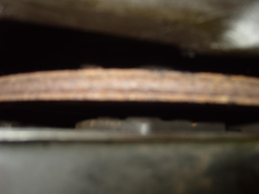

Would these rear Brake discs Pass an MOT? (V12 XJS)
Hi Sorry its not a great Photo but its very hard to focus when you're laying on your back under a Jag, as I keep getting flash backs of an incident I had when trying to remove a Radiator.
So all I really want is your opinion, as to whether or not you think these Rear Wheel Brake Discs on my V12 XJS would be able to pass an MOT.
To be completely honest, I have seen a lot better than these and as such got the job of replacing them penciled in for October.
So please take a look at the Photo and let me know what you think.
Its only rusty on the edge, the faces look ok so its more about the Thickness of the Discs than anything else.

I suspect they'll pass fine. XJSs seem to put almost nothing through their rear brakes. I had an MoTadvisory about rusty edges on the rear discs 6 years ago and I'm still on the same discs! The tester won't care about the thickness, he'll just check the efficiency reading and possibly remark on rust on unworn face. I bet you'll be ok. Let us know how you do!

You have really Cheered me up a lot by saying that!
So lets hope the Tester agrees, as I would expect you already know you cannot play against the Referee!
Needless to say I've put the Wire Brush round the edges but the actual face plates, show no signs of scoring or wear!

OB, I don't know what mine are supposed to look like either, never having; a)owned a British car before, and; b)seen rear brake discs before. The car has well over 175 000 miles on, but the discs are not scored or burned, in fact, to my untrained eye they look new. They seem to be about as thick as yours, not at all like Mercan front brake discs I'm accustomed to seeing.
I reported the visual condition of my rear brakes to another forum, and got positive responses concerning them.
Considering all the examples you have just sitting around, you should be able to look at some of them for a rough sampling and get an idea. I can almost see the story of that now.
orangeblossom,
mine are certainly no better than yours! On the rear of these outboard XJSs, the pads never seem to contact on the outer edge of the disc. Also, it just seems to put most of its braking weight on the front, so rear discs and pads last for ages. I even asked my MoT tester if the rears were actually doing anything, but he assured me that it was meeting the efficiency %. Clean up the x-sectional outer edge with a screwdriver whilst turning the disc so it looks as presentable as possible and I reckon you'll be fine!

As said here, the MOT tester only tests the brake efficiency, so if it passes it passes ! However maintenance is a different matter, and thickness of disc should be measured. Your photo only shows the edge of the disc, not the faces. What do these look like ? The rear brake that fails MOT most often is the handbrake. When this happens most people overhaul the whole shebang at the rear and either remove the calipers, or drop the subframe and remove them, as it is very difficult to work on the handbrake in-situ.
idk but your camera skills won't pass MOT.
just kidding, regardless of image quality this tells us NOTHING. the edges are going to have rust, no issue. The discs will probably have some scoring.
what matters is actual thickness and manufactures specified minimum thickness. We can't tell you anything without sticking a micrometer through the screen

Minimum is .450 inch

I've been under lots of old Jags where the rear brakes were borderline at best. Just because they pass the test *today* doesn't mean they're in tip-top shape, or that they can be ignored for another 10-15-20 years
