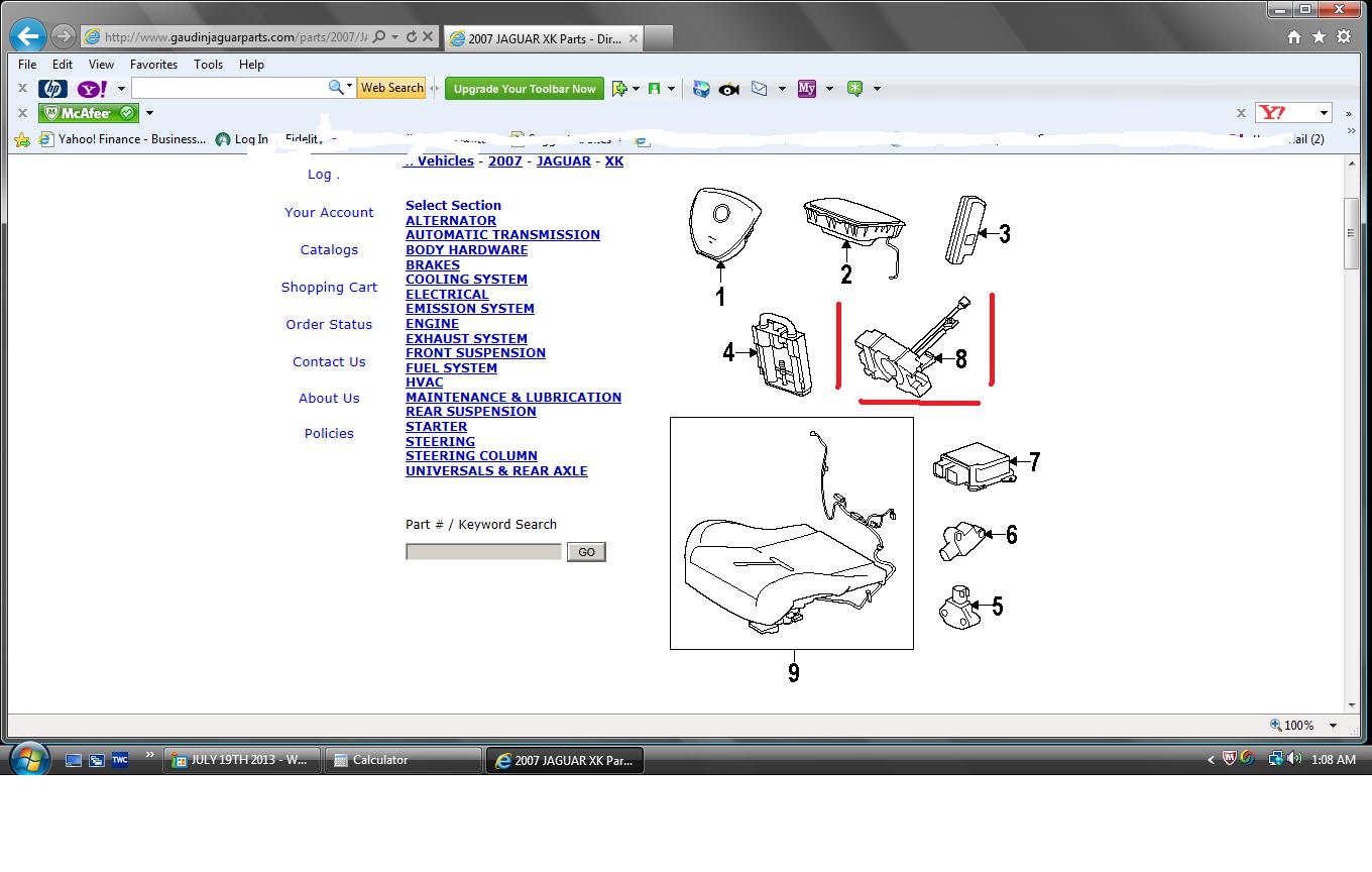

Possible bad clockspring. Start the car with the steering wheel straight ahead. IF there's no bag light, then steer the car far right or left. If the light comes on when you do.....most likely a bad clockspring.
Clockspring is the electrical connection b/t the moving steering wheel and the fixed portion of the car. It makes the electrical connection b/t the moving wheel and fixed portion. Get it?????
If the bag light is on all the time............hard to say what the cause is off hand.
It's item 8 in the attached jpg. Don't try to make sense of the word 'clock' or 'spring'. That is it's name and it's the electrical connection b/t a moving part and a fixed harness. Do a search online for CLOCK SPRING or even the same search on this forum using those words and you'll get hits.
http://video.search.yahoo.com/search...CK+SPRING+WORK I watched the video called Chrysler clockspring and it seemed to give you a good idea of how to replace one. But your car is NOT a chrysler. The Jag workshop manual gives you instructions on how to replace one.
I would not buy a Jag with the airbag light on all the time. Tell them to get it fixed first. I'd also ask if the airbag had ever been deployed before. Clock spring for a Jag XK runs 185-200 bucks.
