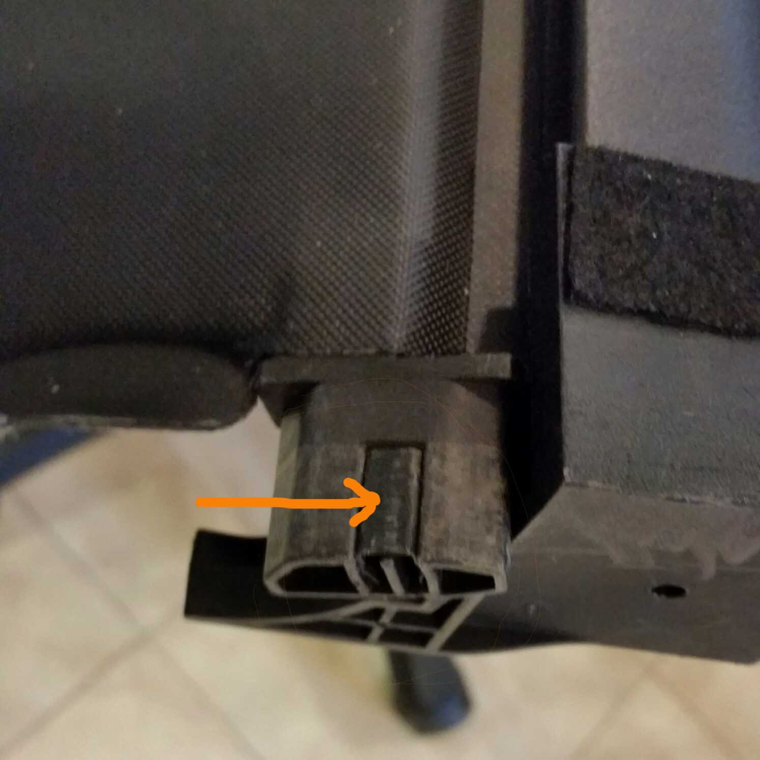

Originally Posted by WhiteXKR
Just metal springs. The sensor is magnetic that detects when the separator shade is in the full open position. The sensor is built into the left side bracket.
Can you please point out the location of the switch. If you have a picture it would be great. Is it triggered by the partition in the closed position or in the open position. If you put a piece of metal in the upper location will it trigger the sensor.

  #35
WhiteXKR's Avatar
Joined: Apr 2010
Posts: 7,657
Likes: 3,021
From: Arlington VA USA
Originally Posted by robbing
Jagtoes, I measured again this morning and it was only reading 11.9v. I don't think it got above 12 yesterday when I charged it and only read 12.2 today with the charger on it. I think I bought the wrong charger so I'm going back to exchange it. I'm going to focus on getting the voltage back up to 12.6.
Is there a way to test the switch? Or is it replaceable?
Check the left side of the luggage separator bar near the edge of the divider. You should see a metal clip as shown in the photo. The sensor detects the presence of this clip when the divider is deployed.
Make sure this clip did not fall off. Could this be the metal clip you found lying in your trunk?

Old Feb 19, 2016 | 10:22 AM
  #36
robbing's Avatar
Joined: Sep 2009
Posts: 263
Likes: 25
That's the clip. YES! I'll check it out.
Old Feb 19, 2016 | 10:32 AM
  #37
robbing's Avatar
Joined: Sep 2009
Posts: 263
Likes: 25
WhiteXKR, I owe you brother. That was it. I knew that clip had to be part of the problem but was looking at the wrong piece. I was thinking it would be part of the main bar. Even after you posted that I had to come back and look to see where it was located. I never thought to look at the part that slides and then goes up. I appreciate everyone's help!
