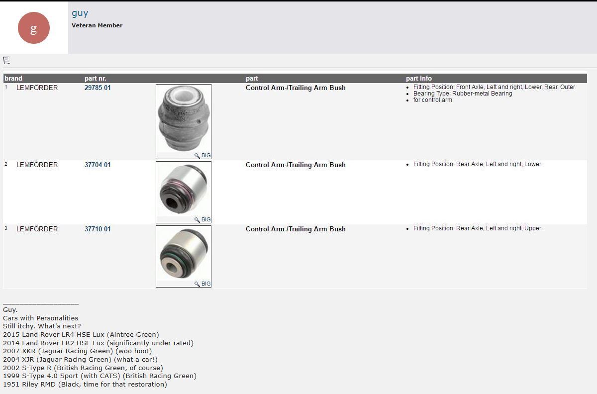

In my search this morning, I found a thread on a suspension chat that had some of your input. I was originally thinking to R&R the bushings. Do you know if that is possible or are they swaged/captured into the arm interface bores? Below is on that chat thread I mention.
