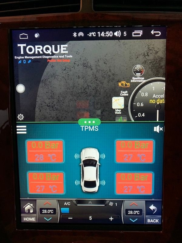

Here are the TPMS options. As I mentioned. I bought the internal bit they sent me the external. TMPS will only read while in motion so that's why readings are null. The TPMS has air pressure low, high and temperature high limit. It also has a battery status and I think Fahrenheit works on this but not sure.
This is what I'm waiting on
This is what they sent
The externals look silly to me
No data because no sensors yet and no driving till Spring

Default TPMS showing PSI and Fahrenheit

Originally Posted by Sean W
Wait. You just went from Celcius to Fahrenheit in these photos. Have you "cracked the code"?

I'd say the TPMS App inside the firmware shows F while the firmware itself is still in C.
As CeeJay wrote, this one is in the app. Just finding the cabin/outdoor temp display code will take a very long time. Fixing it should be fairly easy.
