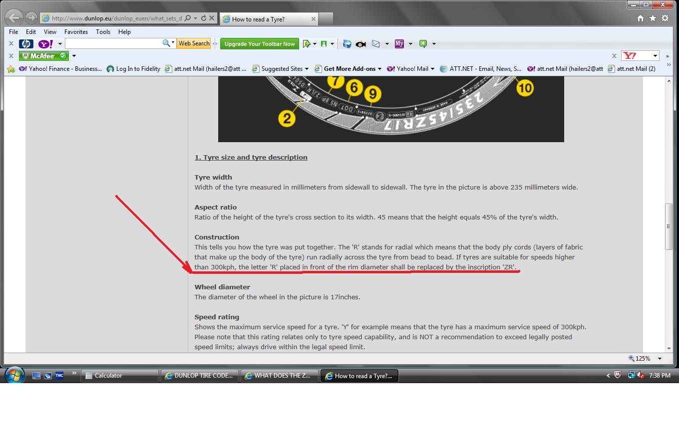

How to read a Tyre?
Until someone comes along to give you the answer, read the above url and look at the jpg I attached with the underlined in red line. ZR it seems to indicate one fast tire and that ZR has to be on the tire due to some regulation of DOT. EDIT: Sorry, didn't see the post above mine. Too late.
