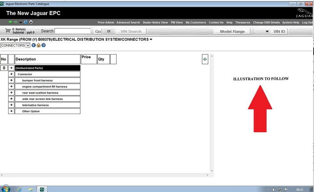

All connectors are easily sourced. See the connectors jpeg for the number on the part. Incidentally, I use “liquid electrical tape” on the end of the connectors, where the harness meets the connector. (easily sourced at any marine shop). The little effort mitigates the need for repairs like this and gives me the value of allowing pressure washing of the engine bay, without ill effect.

Originally Posted by guy
..... See the connectors jpeg for the number on the part. .....
Which connectors jpeg?
My 2018 JEPC has no illustration .......
..... unless I'm looking in the wrong section.
I was told by a local guy that the wiring harness/sensor is part of the shock, which would mean I would have to replace the entire shock to fix it properly. I plan to just use the liquid electrical tape to ensure a tight hold. The sensor holds for awhile but just slowly loses connection over time due to movement.

I’ve been to the parts counter with this diagram and have been assisted, every time.
Also, an internet search of “bilstein electronic dampening connector” shows many, many options.
