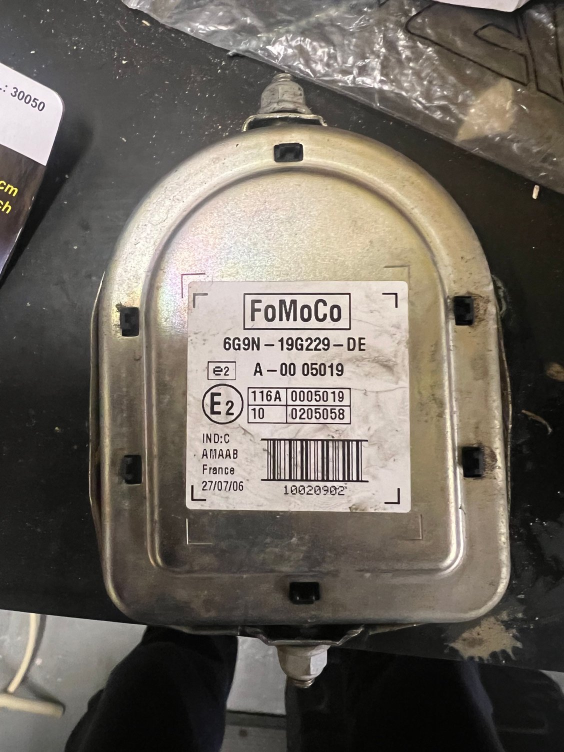

My alarm backup battery located on the firewall hasn’t worked for a while, so as I’ve finished work for Christmas, I thought I’d remove it and check the part number for ordering a new one.
The part number is “6G9N 19G229 DE”, but I can’t find anybody selling new ones, only used ones on eBay which I’m not interested in.
Does anybody know where I can purchase a NEW replacement from, my car is a 2006 4.2 XK?

Are you talking about the whole alarm unit. The battery is inside and not a FRU.
The siren unit is the same as Ford Fiesta which you can get new at a reasonable cost. I got a new one off EBay a couple of years ago.

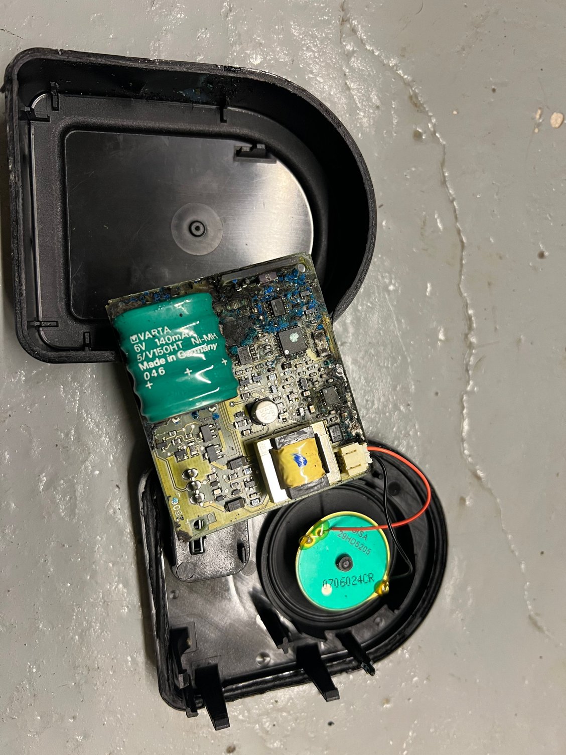

My main battery in the boot started discharging over the course of a week and by checking fuses with an ammeter and removing them, I narrowed it down to the alarm sounder backup battery. When I removed the backup, I prized it open and found it full of water and totally corroded.

Alarm runs off the main car battery, but if a thief disconnects it, the battery (green in pic) in the sounder takes over - this is the state of mine!

As per the photos above, mine was in a similar mess - just get a used sounder from another Jag and use that - forget wasting your time trying to replace the battery - no you dont need to program it

You don't need a new one, I got a used one there's plenty for sale just get one from a newer Jag like I already said

To replace the sounder in my XK it's around an hour, maybe a bit more as it's a bit of a faff due to no room in the firewall area. The sounder makes a distinctive beep when armed, and obviously sounds if the vehicle is intruded upon or jacked up so worthwhile replacing. It's not worth repairing the old unit, they aren't expensive and they are used in many vehicles including Volvo so you don't need to think this is a unique Jaguar part, like most of the parts on a Jaguar they are made to accommodate many vehicles just as the fuel pressure sensor and lot's of more parts.
The only thing to be mindful of is the holding bracket needs to have the screws in the correct place, so I got a used one from a different Jag no idea what model it was but it wasn't a XK and it fitted fine
