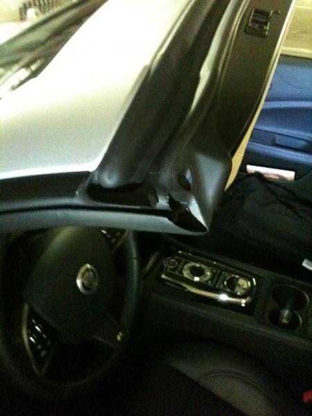

Noticed this when picking up the car at the dealership from service today; got the tires replaced and the brake issue attended to and I'll write a seperate post about the results.
It appears the rubber moulding is deformed on the driver's side, I can't believe I never noticed this before picking up the car today unless something happended at the dealership? This section of moulding is all one piece going all around the upper and sides of the windshield, but only ill fitting on one side.
The guys in service are all trying very hard to help correct my car's initial flaws and I hope these flaws will finally come to an end soon. I need to get this winshield moulding corrected and the rattle in the driver rear area corrected to finally cap off an ever growing list of initial qulaity problems; hopefully this will be it for a long while.
What do you guys think caused the rubber to get like this? Anyone here notice this before? Drivers side picture on left and passenger side on right, I tried pushing the moulding to fit better but there is no extra play in it at all. This looks like crap and can't possibly be normal fit and finish.

Thanks for bringing this to our attention. I think this is an area where few, if any, of us ever look at. I know I haven't, until now. My car is almost 4 years old and just turned 30,000 miles and I give the top a real workout. Although I drive it only on nice days, I usually put the top down and put it back up whenever I park. So it goes up and down at least 3-4 times each day.
I just looked at those seals and they fit perfectly on both sides, with no gap between sections.
Your car simply isn't right, and your dealer should fix it under warranty.

I think the part that i need goes in front of #13 and fits around the top and sides of the windscreen; it looks as if it's #6 here, but on my car this weatherstrip extends from the windshield's A pillar back to where I showed the gap in the pics conecting to part #13 that you mentioned.The illistration below may be for a coupe.
I've enclosed a pic of the suspect part; wish it was #13 as it would be so much easier to install, #6 looks like a big job where the entire weather seal going around the windscreen needs to be replaced.

Hardly, but a discerning individual that expects things to function/appear properly as designed, let alone on a $110,000.00 car.
I'm at the dealership now and we discovered that 80% of the 2012 verts have the defective weather seal and only affecting the drivers side. We checked the used car lot too and found the 07-09's were all perfect on both sides; there were no 11's there. So it appears whomever Jag/TaTa is now having produce this part is out of spec/defective.
We also discovered my drivers side headlight assembly was not fitted correctly at the factory as it was sticking up by about half an inch.
