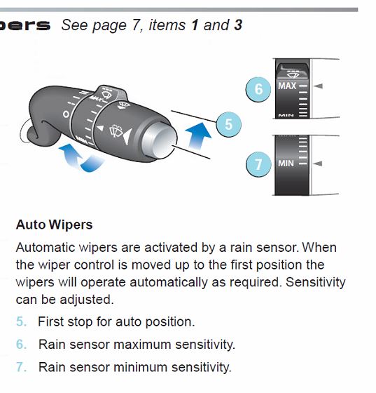

According to the 2011 US brochure they were standard on all models and your description matches the picture in the quick guide so I assume they changed on later models.
Have you tried putting the lever in the first position and playing a hose over the windscreen?

Thanks u102768 That was it! The first detent is the Auto mode. As Ed China would say, "Problem solved."
