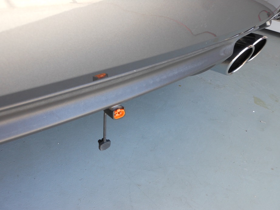

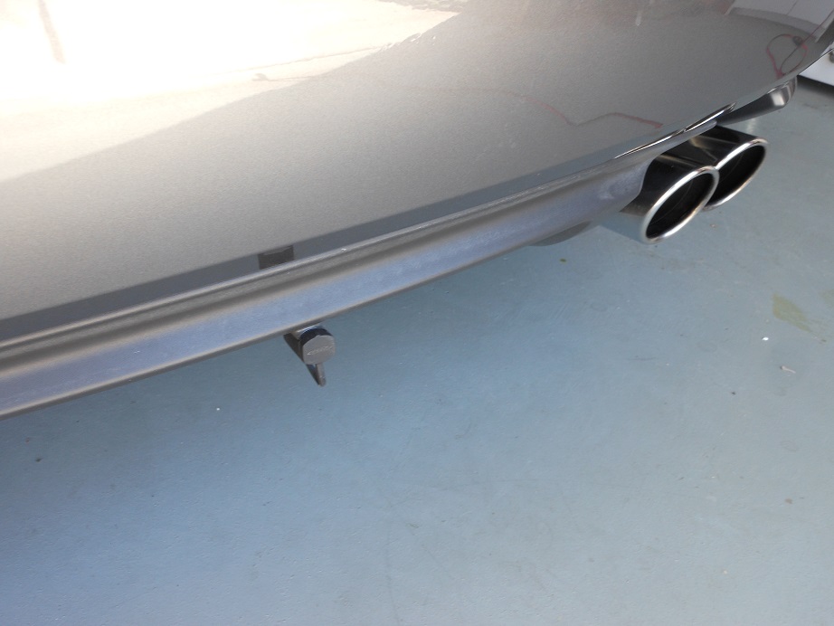

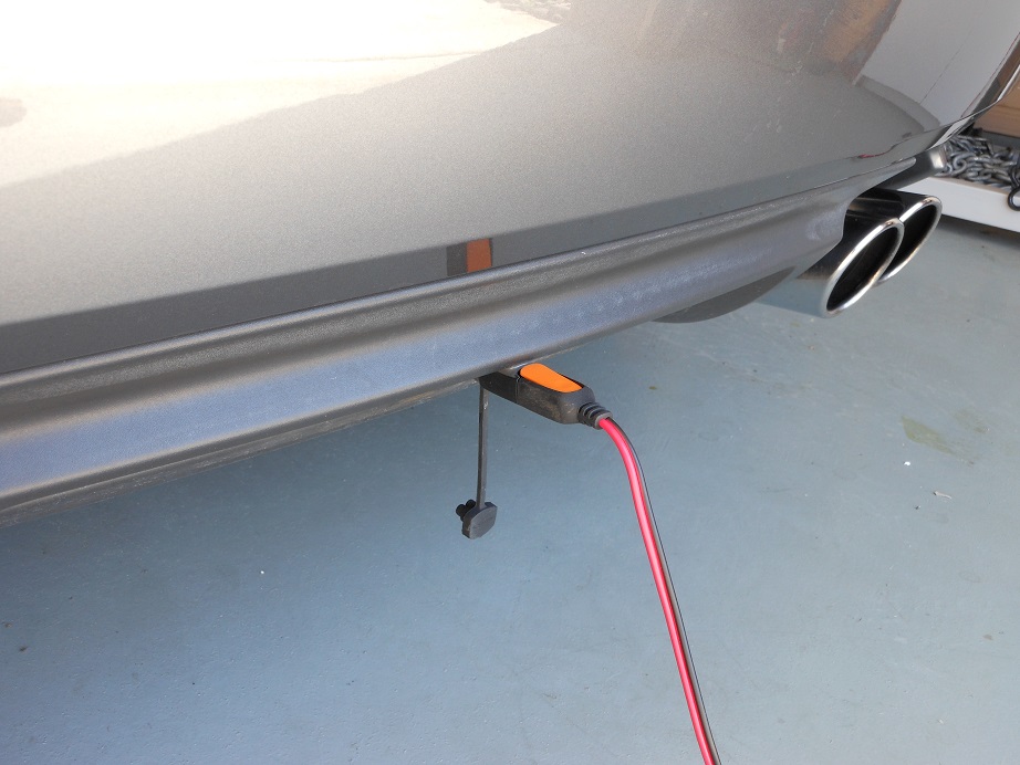

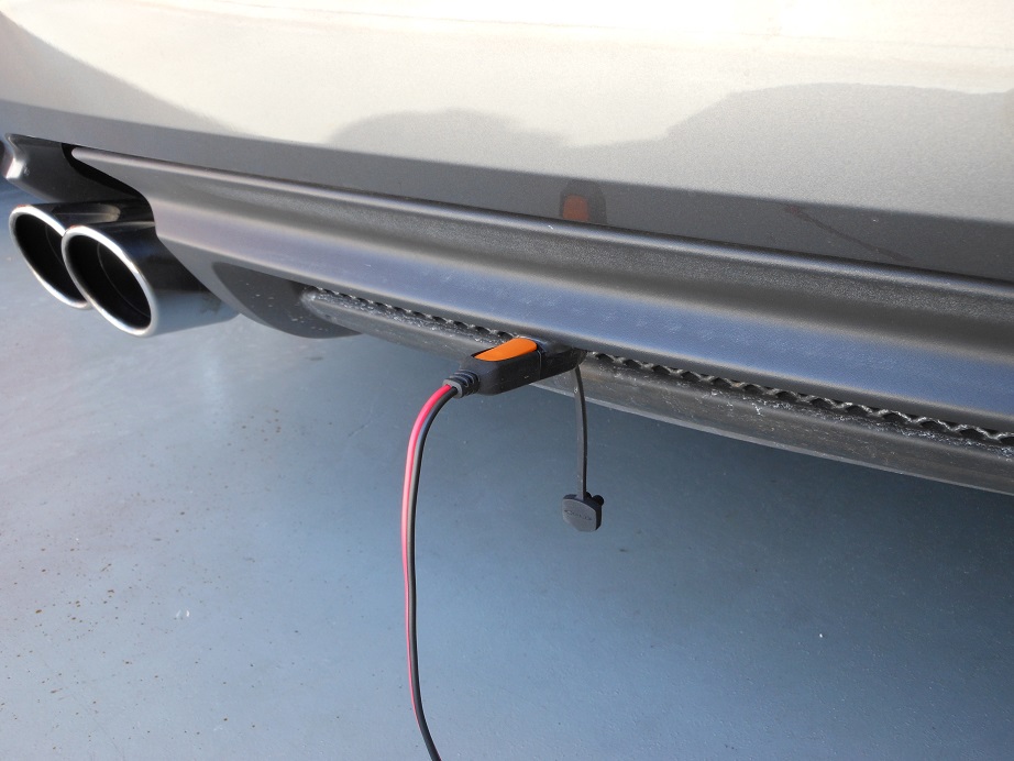

Simple solution.......I have a CTEK3300 connected directly to the battery since my XKR is a 2009. I used the eyelets that came with the CTEK3300 and attached them to the 10mm battery terminals on the battery located in the trunk.
On a 2010 or later MY, you can connect the eyelet to the "positive" 10mm battery terminal and connect the black to a ground bolt.
Then the line from the battery gets connected to a CTEK Comfort Extension (8' extra feet) and runs out thru the rear end below the rear bumper. There is a rubber grommet on the floor near the spare tire wheel well, and the cord of placed thru the hole then sealed with silicone. I never have to open the trunk to connect. I just simple plug the CTEK connector into the connector on the car and the battery is constantly maintained.
So simple.
Click the image once to open, then click it again to enlarge the image.
