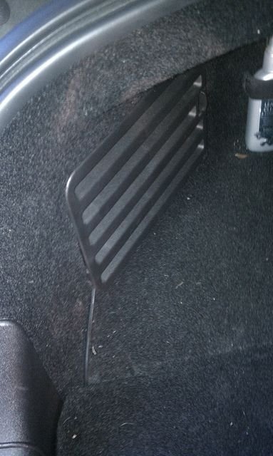

The right way to charge the batt is removing the cover on the left side
in the back of trunk. There is a pole with a rubber cover on it for the positive
charger lead to connect to.

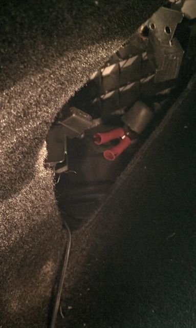

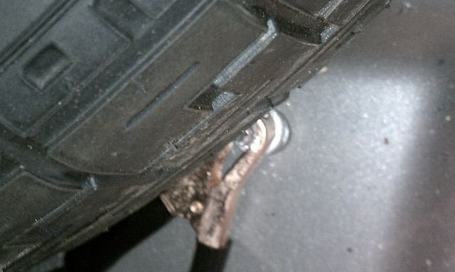

I use the remote battery terminals in the trunk (boot). The positive terminal is behind the black plastic cover on the left side:
Remove the cover and you'll find the positive terminal under a black rubber cover. Attached to that + terminal is the red alligator clip from the positive pigtail of my battery maintainer:
The negative pigtail of my battery maintainer is alligator-clipped to the remote negative battery terminal in the spare tire compartment. It's hard to find because it looks like a bolt protruding up from the floor. It's almost in the center, very close to the rear most part of the trunk (boot) by the bumper and may be under the spare tire, like mine:

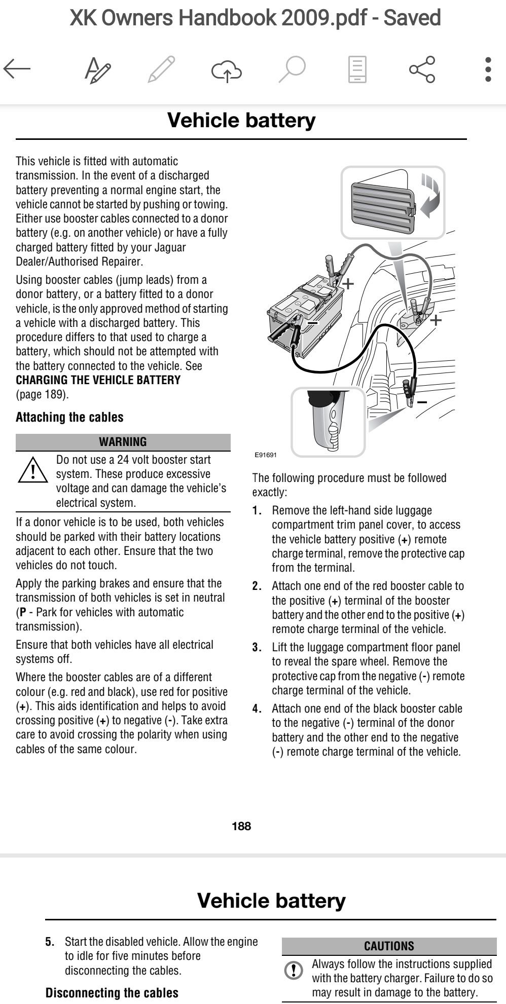

Of course, you can use any "good" chassis ground, but how do you know that it's a good ground? My 2009 Owner's Handbook says to use the remote negative terminal in the trunk, so that's what I do.
For the 4.2L models, you can also use the eyelet connectors to permanently attach the positive and negative pigtails directly to their respective positive and negative battery posts.
The 5.0L models are similar, except for the negative battery maintainer pigtail. Because the Battery Monitoring System Module is attached to the negative battery terminal, the negative battery maintainer pigtail must be attached to a chassis ground. Otherwise, that BMS Module may be damaged. For a complete discussion of the BMS Module, see:
