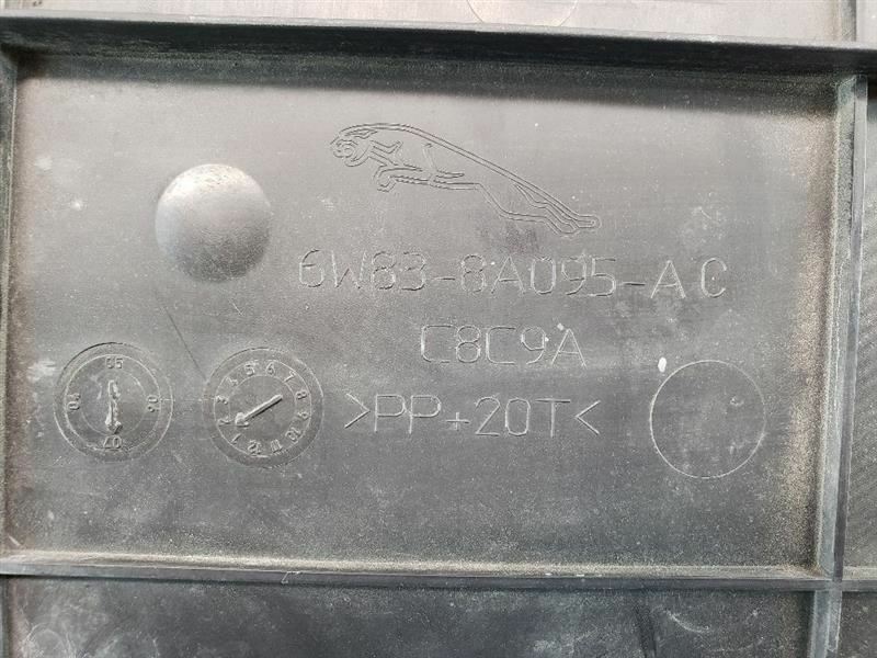

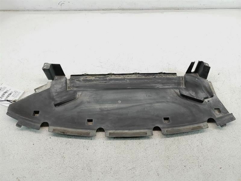

Question, underneath the car you have the front splash guard under tray, then when you take that off there is another black plastic guard tray that is attached underneath. it has a high side on the right hand and a slot on the left hand side each side looking different. I tried looking for it in the jpec but i cant find it also a lot of images are missing.
Anyone have any idea what this small guard part number is? thanks
Update: found it.
part number is: c2p5347 Center Lower Engine Cover
At least thats what this says on ebay: https://www.ebay.com/itm/154298591151

If I remember right, the Non-/R 4.2 models had only the right-hand air filter box. That would make the above picture correct for the base 4.2 car. All supercharged and everything with a 5.0 had dual air boxes, one each side. I certainly don't guarantee my assessment as I've not seen a non-supercharged 4.2 lower cover though.
so this covers the base just inside of the radiators and steering rack, then there is the larger undertray splash shield over the top of it.
The JEPC has missing image files in it and I am unable tocheck this part properly, I even re-installed it to make sure.
The picture of that item shows a C8C number>
The air filter box is on the left-hand side (at least on the LHD cars), but I just don’t recall that second plastic guard on mine (but it’s been awhile since I took off the big splash guard).
Thank you sir, now I know. Sorry, Unklebuck, I was wrong.
