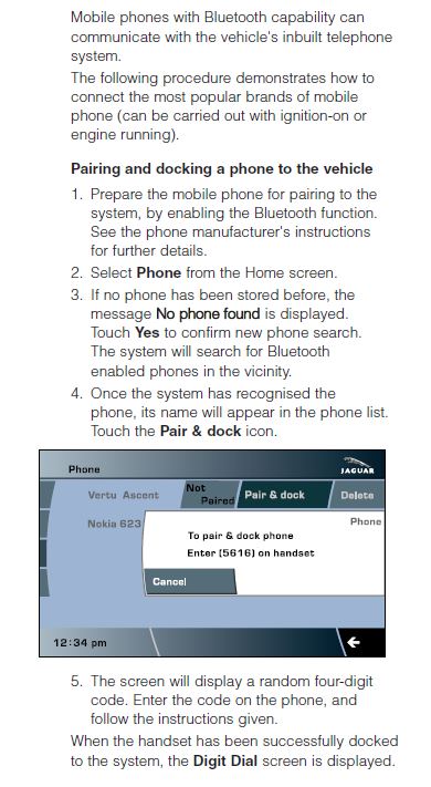

Welcome to the forum! As far as I am aware all XK's came fitted with Bluetooth as standard so it should just be a case of connecting your phone to that.
The early XK's had issues displaying phone book entries on Android phones but I have never had any issues connecting my iPhones which ranged from 3G's to my current 8 Plus.
A Bluetooth module from a later car will sort out the issues with the Android phones but you should still be able to link it and make calls.
