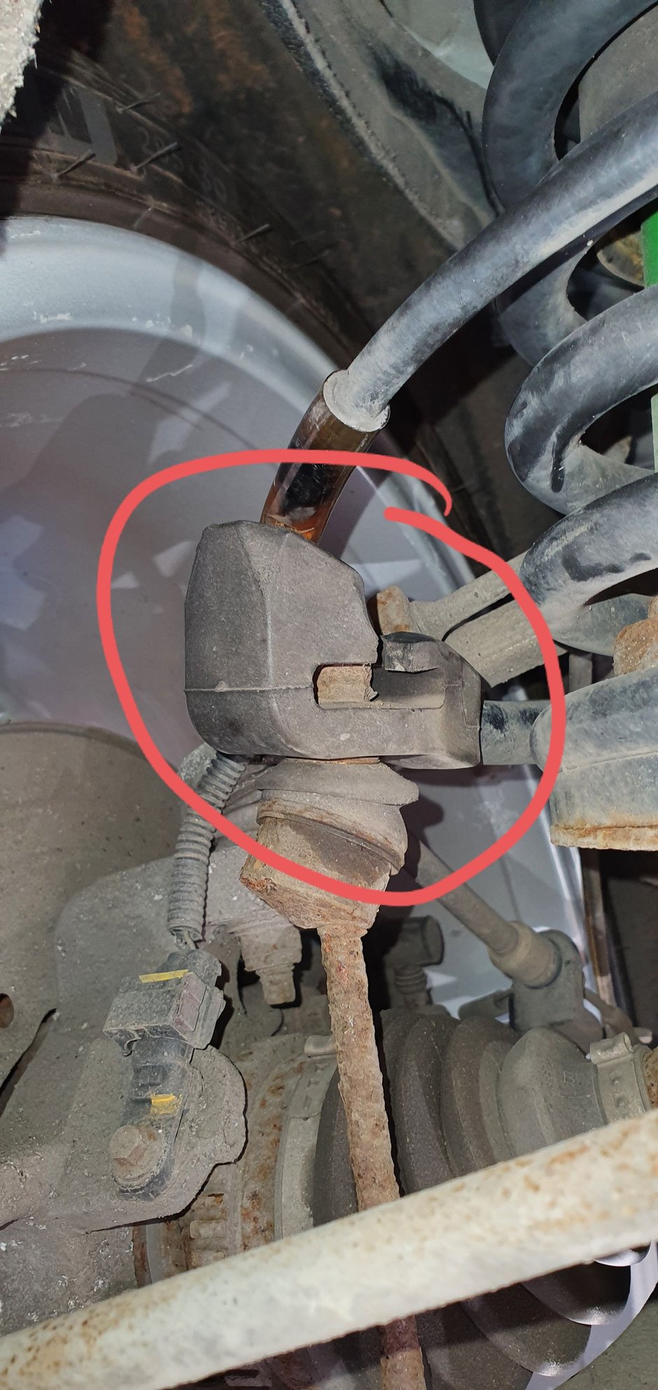

Morning all,
my dad's 4.2 XKR has a split rear bump stop, that is causing the handbrake cable to rub on the drop link bolt (sway bar link for you Americans)
I can't seem to find a replacement part for it, any help would be appreciated to find a replacement! Thank you
Old Feb 6, 2021 | 06:03 AM
Tricky to find in JEPC as it's called Stabiliser Link Deflector or simply Deflector and the illustration looks nothing like it.
P/N C2D20594
S N G Barratt are showing it as special order:
https://www.sngbarratt.com/English/#...?saveBranch=UK
