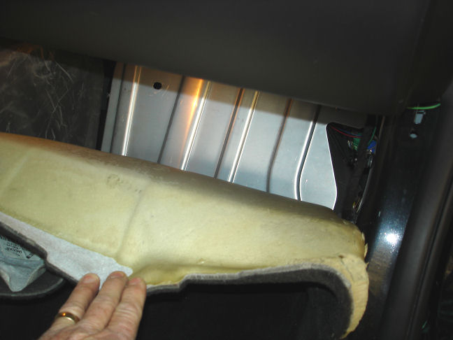

Start by pulling the door sill panel up with your hand. Then the side panel in the passenger footwell pulls back toward the rear of the car to remove.
then pull the carpet back to get access to things. It takes some effort as the carpet is stiff.

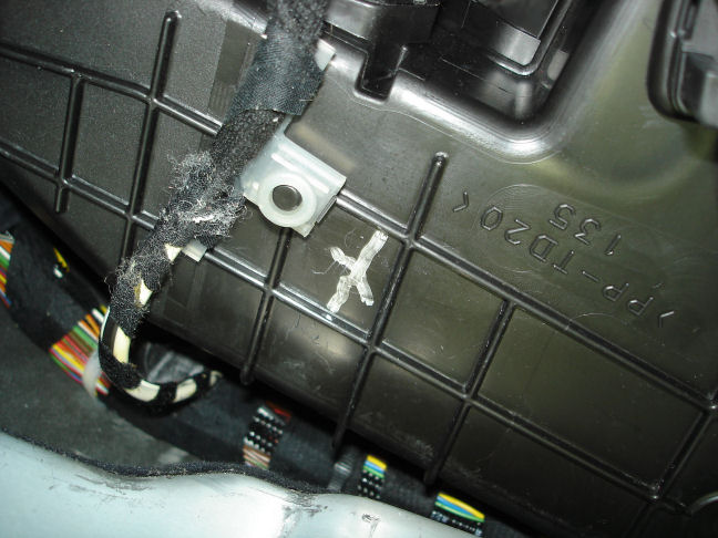

this is the view looking up at the plastic box which contains the condenser unit inside. It is slightly lower at the front of the unit, but its hard to drill a perpendicular hole in this area, so I targeted one with an X a little to the rear

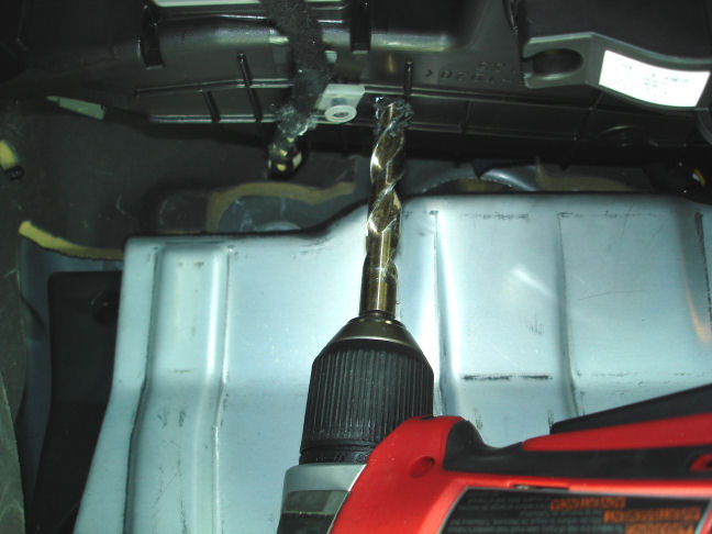

A right angle drill gives you more room to drill. You can see if I chose a site closer to the front, my drill would have to be angled preventing a perpendicular drilling approach. I drilled carefully as Hawaii recommended but after I broke through in this location there was nothing inside to damage.

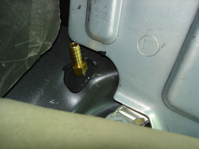

This is the site I chose to drill through the floor. It worked out fine but you may want to go a little closer to the outside of the car (away from the transmission tunnel) The picture below shows where I exited beneath the car.

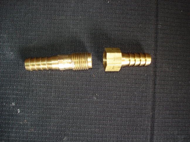

Because of the proximity to the exhaust pipe I decided to use a brass fitting. I was concerned the plastic tubing would melt and seal itself. I found some brass fittings in my "junk" drawer that worked out.
I assembled these parts and put the long end through the flow secured by some JB Weld
I put some JB Weld on the threads of another fitting I had and threaded it into the condenser box.
from there I just routed a plastic tube between the two brass fittings.

Maybe use a flex drill extension to get closer to the bulkhead - only problem may be that the chuck may not take the right size of drill and there's no space inside so you can't ream it.
On the other hand, maybe it's not a big deal if the hole is drilled at a slight angle - you're going to seal it all anyway.

You can always put an adjustable stop on the drill bit to control the depth , They make them for most size drill bits. BL
