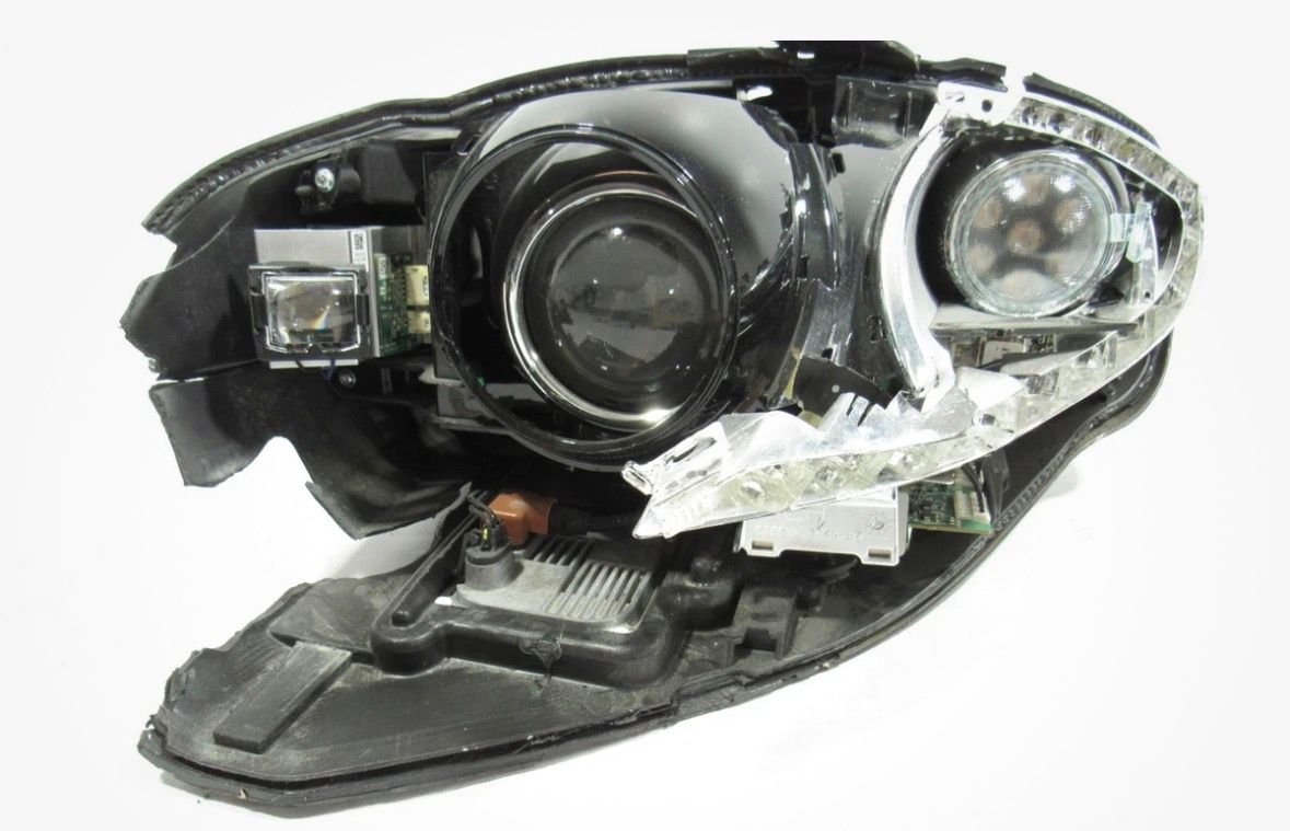

Old Jan 17, 2026 | 07:16 AM
kj07xk's Avatar
Joined: Jan 2015
Posts: 5,323
Likes: 2,597
I could be wrong, but looking at this broken 2014 headlight (from an eBay listing), it looks like everything else is LED in there.
thank you! I guess I have some LED bulbs I need to return. You don’t by any chance know if the rear brake lights and reverse lights are LED do you?
Old Jan 17, 2026 | 09:40 AM
kj07xk's Avatar
Joined: Jan 2015
Posts: 5,323
Likes: 2,597
On your 2015, the rear tail/brake/turn/backup, are all LED. Those units are all LED.
