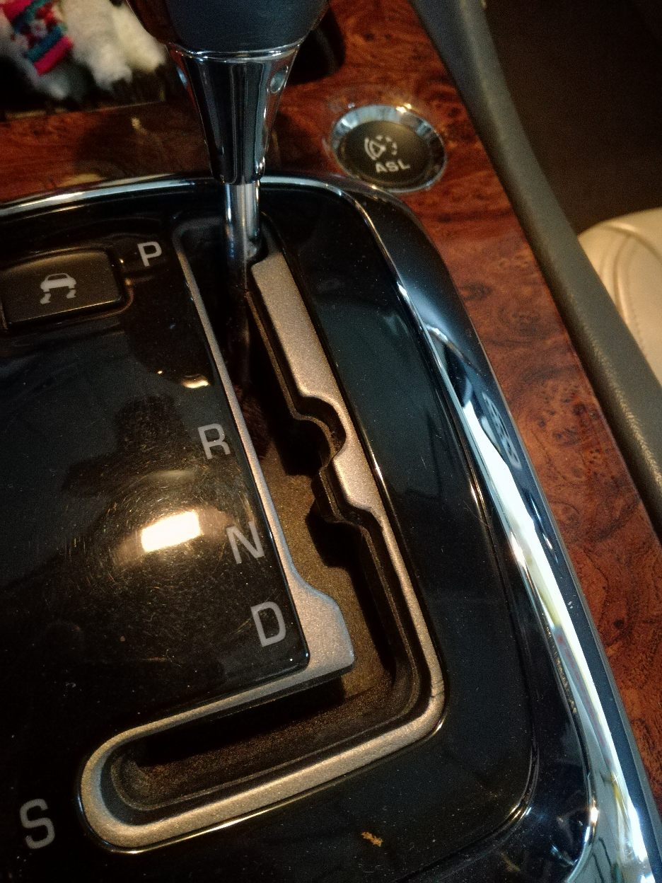

I had the same issue, just dissasemble the complete unit and remove the remaining chrome from the plastic part. repaint it in a color you like (recommend dark silver) and for best result you should use a 2k clear coat on top.
Ciao
Frank

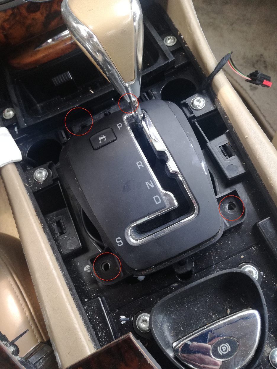

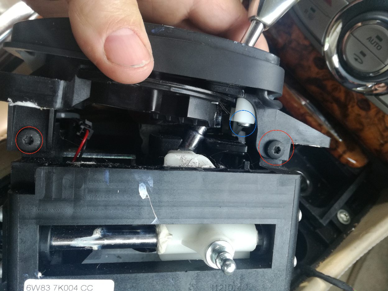

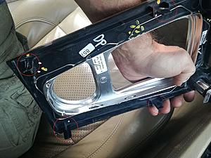

when u remove the console watch out, donīt break the plastic clips. lift it with a strong scraper left, right, left, right.
4 torx bolts will hold the shifter, remove them. you will not be able to pull the shifter out like on the image, because
the shifter rod is still attached. you only have to lift the shifter unit to get access to the 4 bolts l+r. that is a bit tricky
and watch out that you donīt drop them. after that remove the gear knob then you could remove the plastic cover.
there a a few more screws (one marked blue) to remove. make photos for backup.
good luck
