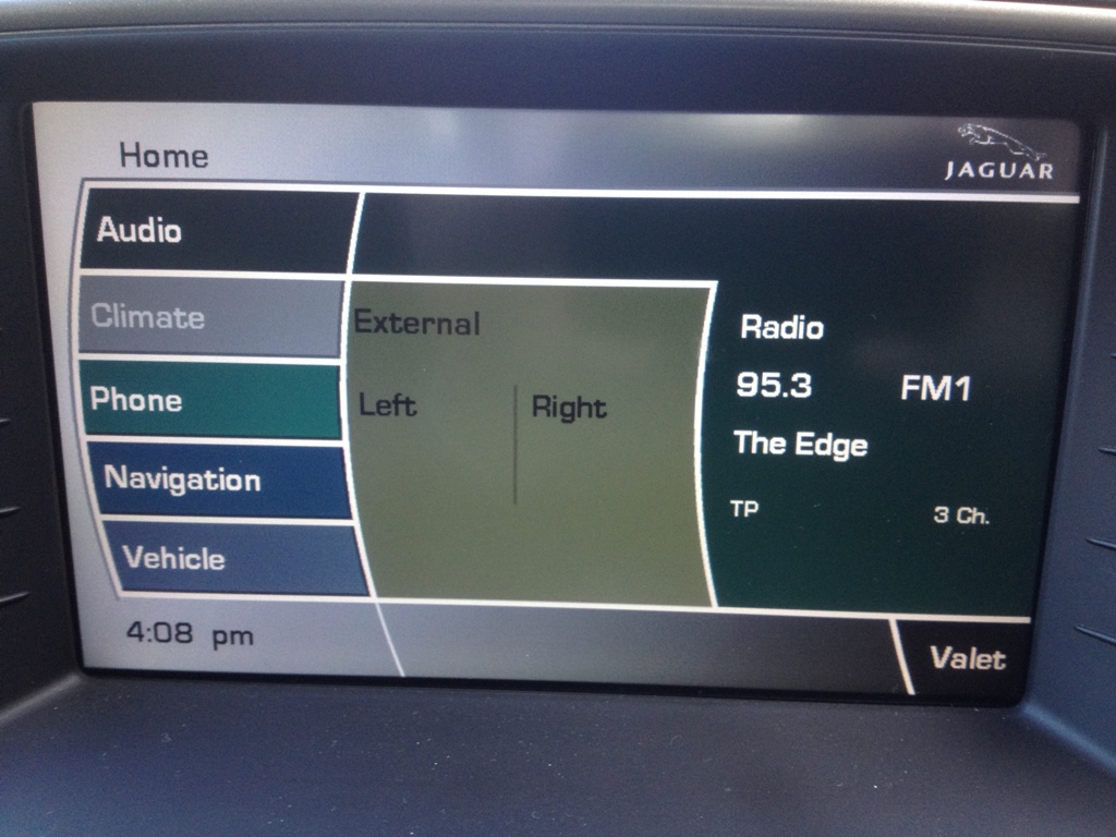

When I started my car last night to head home from work I was treated to the non-functioning climate display that ShadyJC reported. All the controls seemed to work just nothing showing on the screen. Turning off and on didn't fix it so I suspect that is another thing that is on the convenience mode power circuit.
After spending the night on charge I then got the missing centre dash display this morning. Switching off and on fixed that one.
I think a new battery might be required soon!

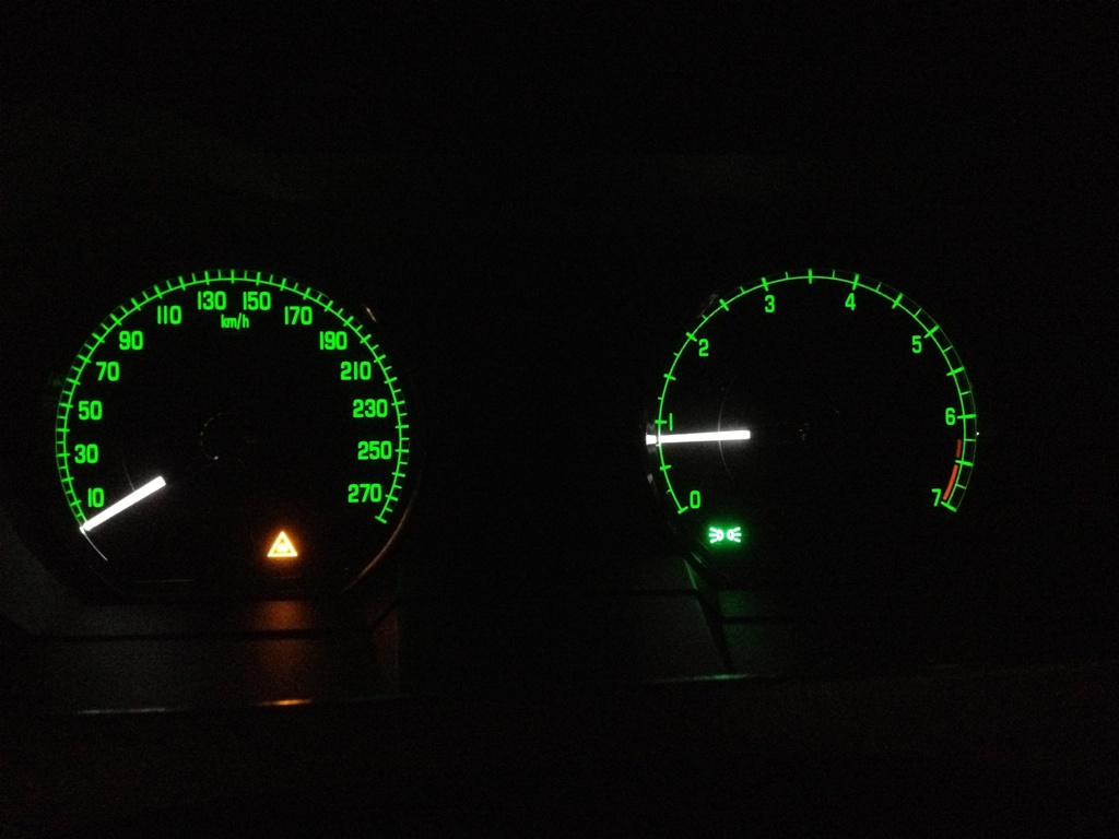

I still haven't changed my battery and was treated to a few more symptoms recently. The touch screen started flashing on and off when I started the car. I also got a warning that the boot I had just closed was still ajar so got out to close it. When I got back in the touch screen had stopped flashing but was now hung.
I had to stop very briefly on the way home to pick something up and when I started the car again the touch screen came back to life but a few minutes in to the journey a critical warning flashed up saying that the engine temperature sensor was not functioning.
I assumed it was battery related but decided to pull over and check. As I pulled over the warning light went off so I carried on home as I was pretty close. As I put the car in to the garage I became aware of a strange noise so wound the window down and realised the cooling fans were on full bore. I switched the engine off and looked under the bonnet but there were no signs of over heating so I plugged by wireless OBD dongle in to the diagnostic port and went for a drive. The coolant temperature was within the normal range so I assume the car puts the fans on full as a precaution if the temperature sensor stops working.
It is a shame that modern cars are so sensitive to voltage. I have had cars in my long distant past where the battery only just had enough juice to turn the engine over and would sound like it started on the last drop but once started would be fine. Apart from the electrical glitches there is no sign that my battery is on the way out.
I have tried to buy an AGM battery twice recently and was met with blank looks here in little old New Zealand.
