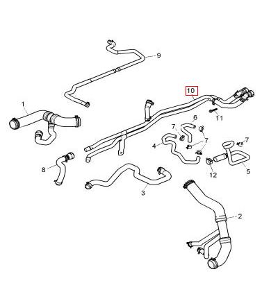

My coolant hose that goes from the expansion tank to a metal rail (about 4 inches long) started to leak. The local Jag dealer says it is not available unless you buy an entire new rail for $140! Does anyone have an idea where I can get one? The two ends are slightly different diameter, so I can't find a generic one locally. Any ideas?

He is right, it is not listed separately in the parts book.
Part number is C2P2186 for the assembly. List price is $126.50. Dealer really should not charge more than that. It is $98.66 here: https://www.parts.com/index.cfm?fuse...R-COOLING-PIPE

Thanks for the quick reply! Parts.com doesn't really say that part includes the little hose are you sure it does? $100 for a 4 inch hose is killing me....

The hose is more evident of this sketch from the Electronic Parts Catalog (item 10).
